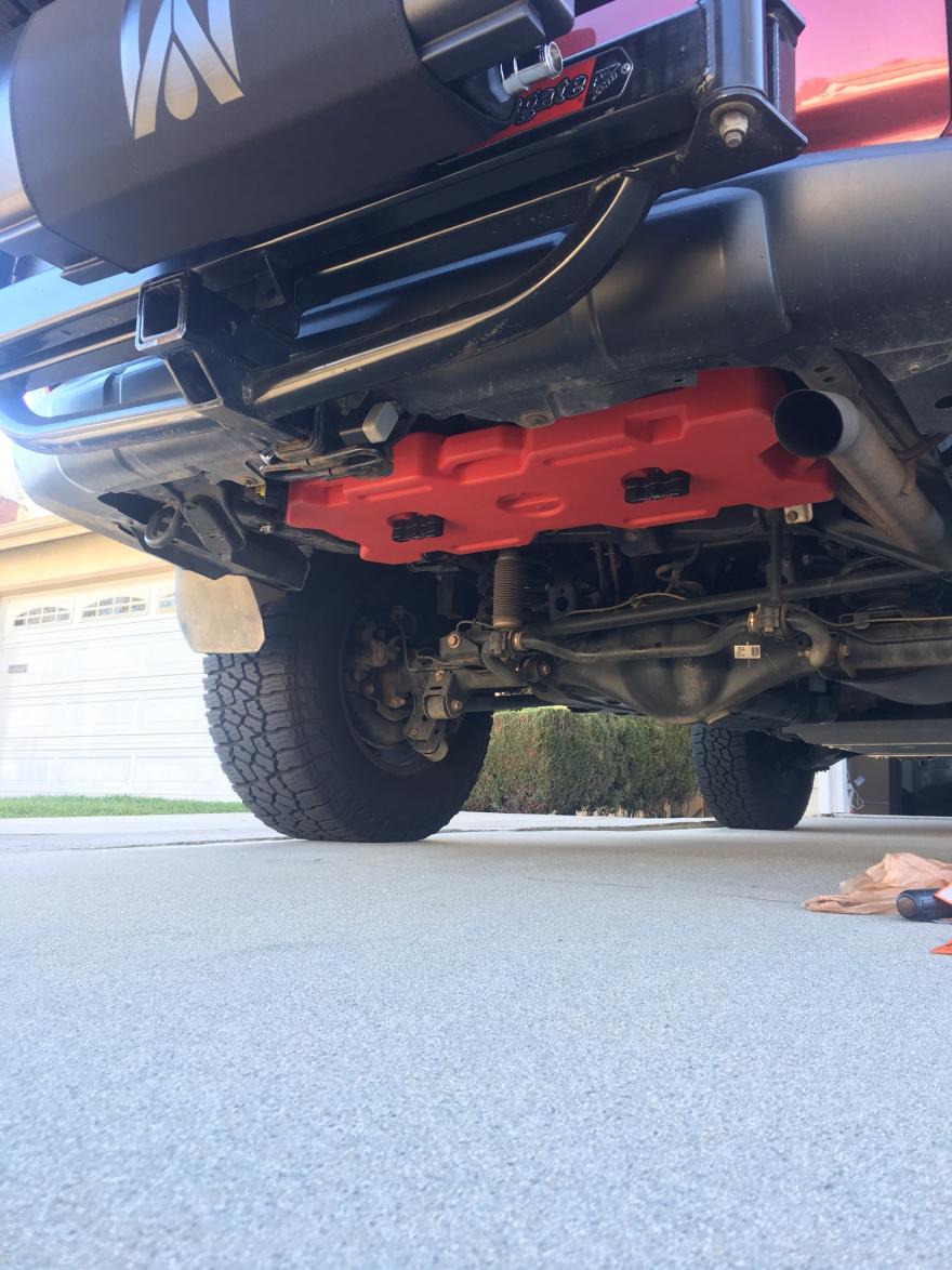

I was going to ask the Forum "anyone mount a rotopax under the spare tire". For those times I want to go somewhere, not put on my roof rack cause I can put everything inside, and just have that feeling of "yah, I'm covered in case I forget I'm low on gas".

Anyone use one of these and will it work for the 4runner?
I did this but my spare is mounted on a tire carrier
I'm thinking that's a little too close to the ground for me. It may work...
I think (I hope) this is for mounting it on the outside of a spare tire that is not under the vehicle.
Edit: Just saw the pic. Seems pretty dangerous without a skid plate. I like this idea better.
