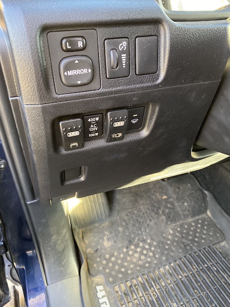

I've just got ARB front locker installed.
Here is where switches are located (not sure how to put a pic in-between text)..
Now... it really feels like it's way too easy to accidentally turn it on while driving. Yeah, I know that the compressor needs to be switched on first and then locker will engage but I still feel rather anxious.. Also my wife and kids drive the truck from time to time.. so...
Does anyone know if there are automotive switches with safety cover or safety lock of some kind?
I only found this on amazon . But was wondering if there is anything better looking :)

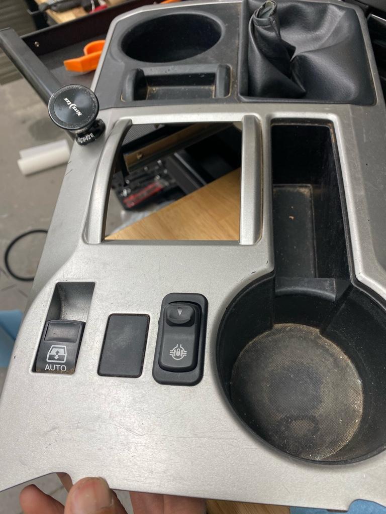

I would be nervous about that too. I’m surprised ARB doesn’t include a safety switch. Locking up your front at 75mph would probably be a bad day. Here is a shot of the Eaton locker switch that I have. It has a safety lock built in. You may be able to source one and make it work?
