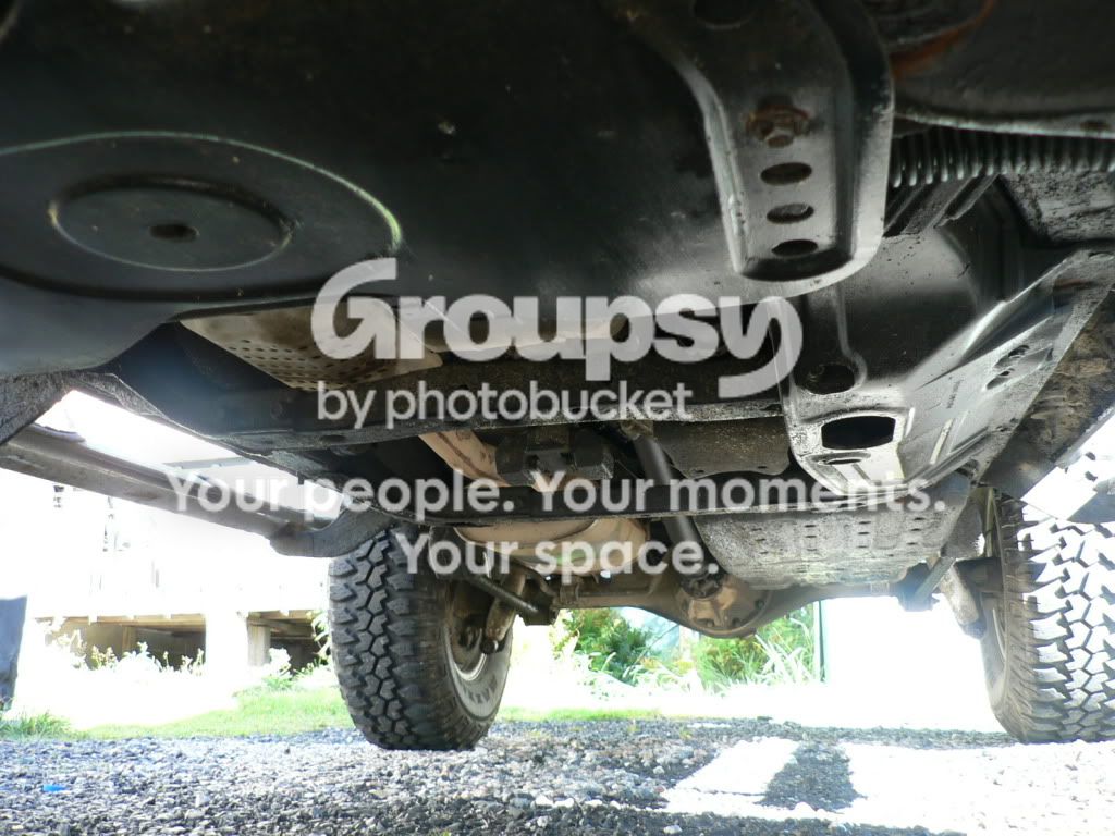

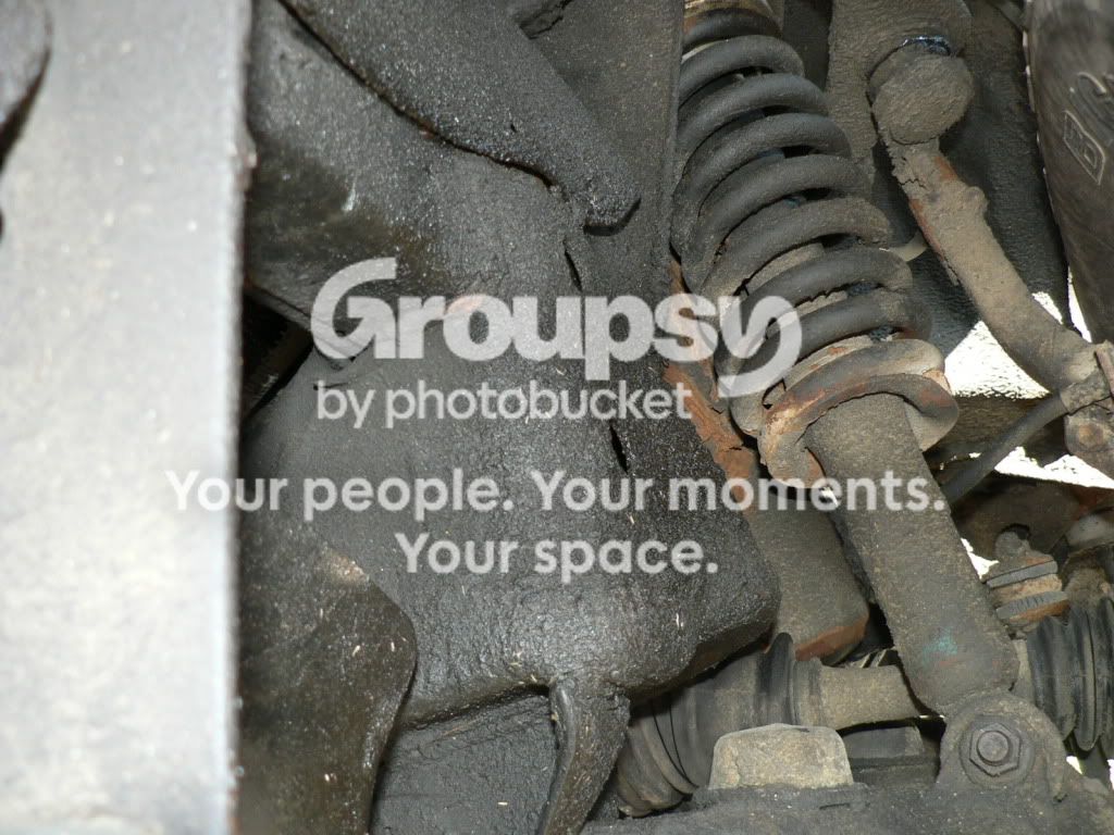

POR-15 is a great product....but I couldnt' be bothered to spend that much time cleaning and painting the undercarriage. I went a different route and just coated everything with grease and oil.

I'm not going to lie, it's messy to work on....but other than spraying it once a year....it's not very labour intensive.

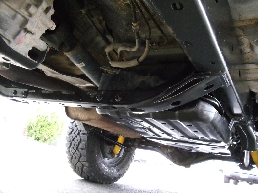

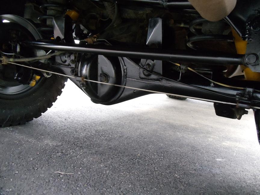

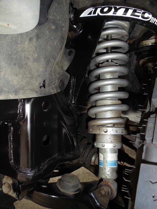

It was a major pain all that cleaning and paiting and took me several hours but am happy with how it came out

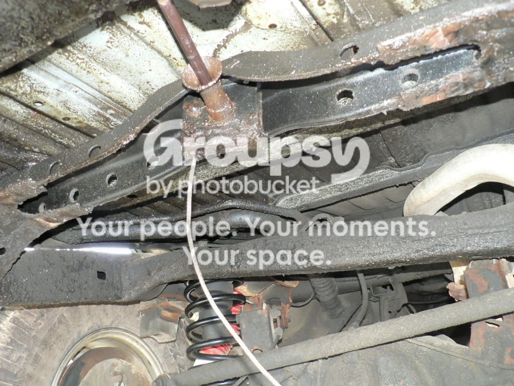

Not to hijack my own thread, but I was putting my new wheels on last night and noticed this:
DSCF2004.jpg~original
Have you done your LBJ's yet? While the rest of the country has lift parties and offroad adventures maybe we could have a LBJ and Rust session?
You were also dead on- no rubbing with the new rubber!
