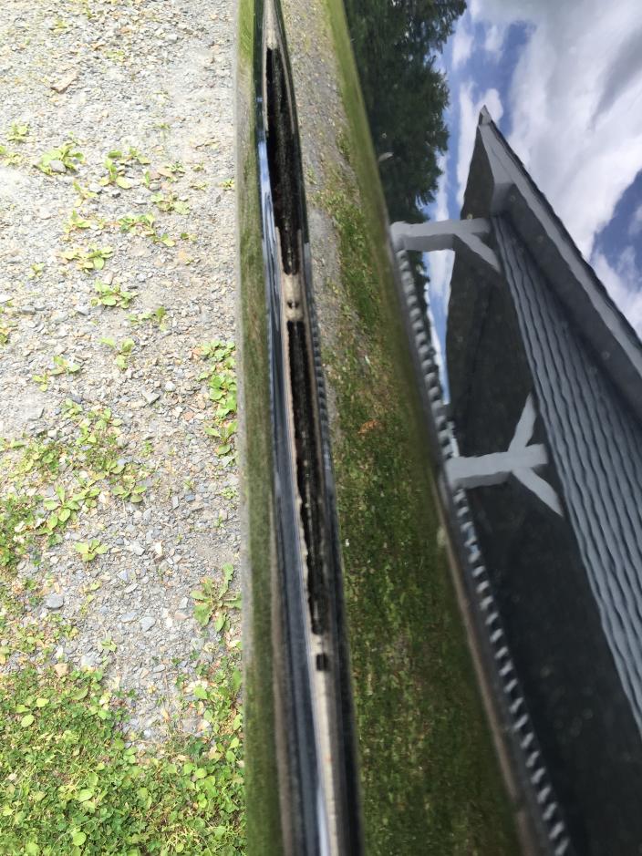

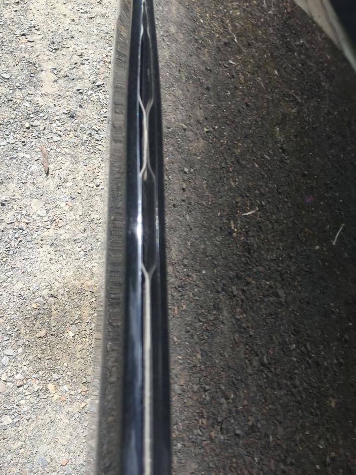

My initial undercoating (krown) warped my OEM fender flares VERY badly. They pulled away from the body. The 'L' shaped profile was no longer L shaped. I taped and re-taped them with 3M VHB tape, but in the end they were too warped to do anything with. I wound up putting bushwacker fender flares on, because it was cheaper than replacing the OEM flares with new paint. hindsight, I wish I had just replaced the OEM fender flares.

here's a picture of the original tape peeling away with a warped fender flare,
And then a picture of 3M's very high bond tape (used with the proper cleaning and 3M primer) peeling away.
plastics and oil do not mix! The Krown guy did a proper application on the fenders (this is where body rust is going to start) - but in the end, I wound up screwing around with these MF fender flares for months on end before I got the bushwackers. Learn from my mistake.
