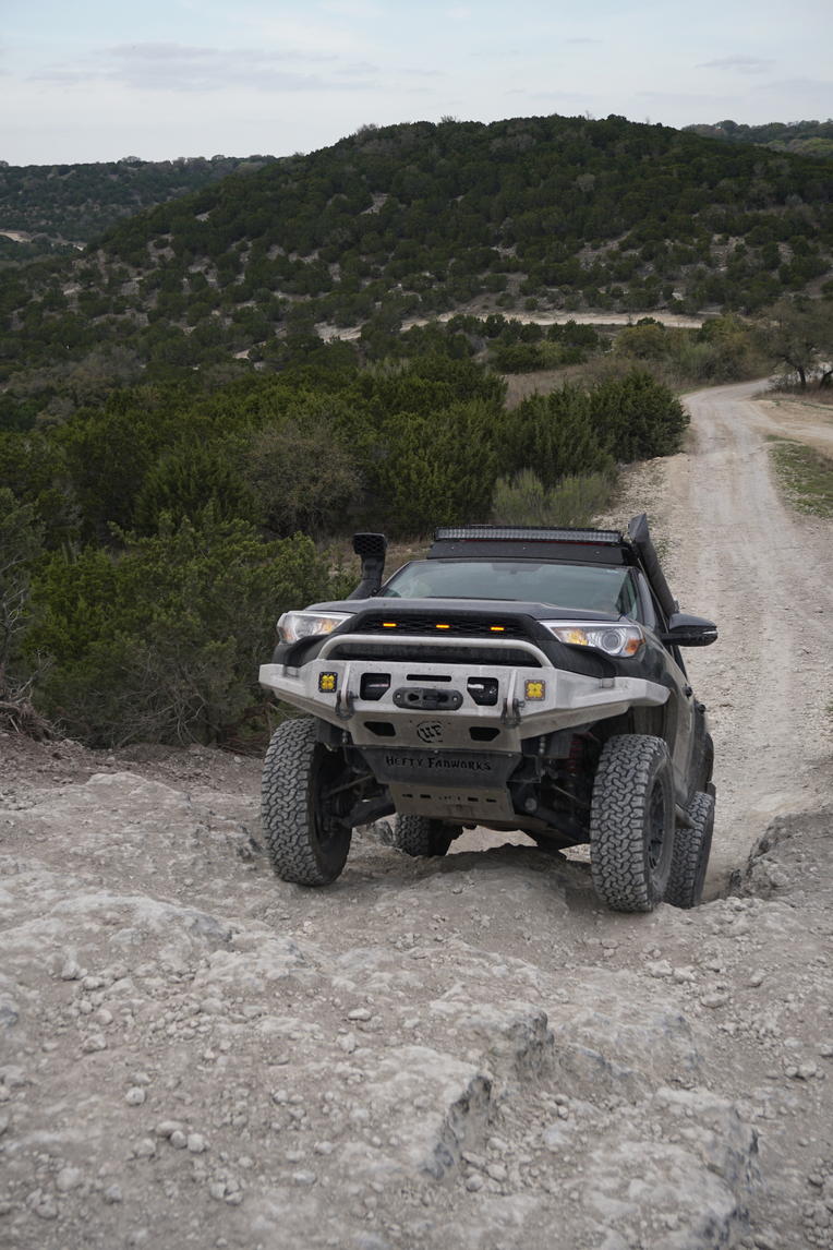

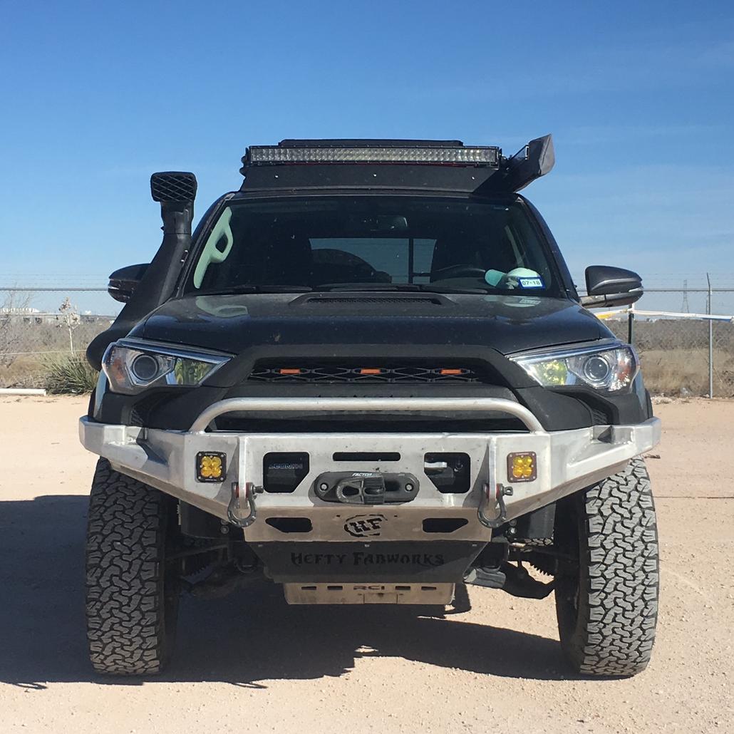

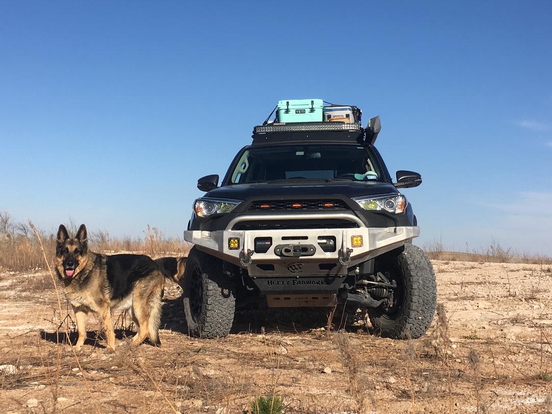

[MENTION=96425]JSparky[/MENTION] My front hefty bumper is bare aluminum right now. It's started to dull some and is soft so it shows a few little dings and scratches from road debris, but no issues with it at all and I actually think it looks kind of cool.
I had bullet liner on my front and rear, but after an accident I found out a wash primer wasn't applied to the front bumper prior to coating, which caused the liner not to adhere properly to the aluminum. So i peeled it down to the bare metal.
If the bumper covers and fenders weren't sprayed and I had a white or silver 4R I may consider leaving it bare for good, but I am looking forward to having it resprayed sometime this summer

The reason companies offer bare steel/bare metal is that many people like to do their own painting/bedlining, either themselves or at a shop. You should really avoid bare metal. Even doing some basic acid wash, rinse, and then spray with clear coat would be much more beneficial.
