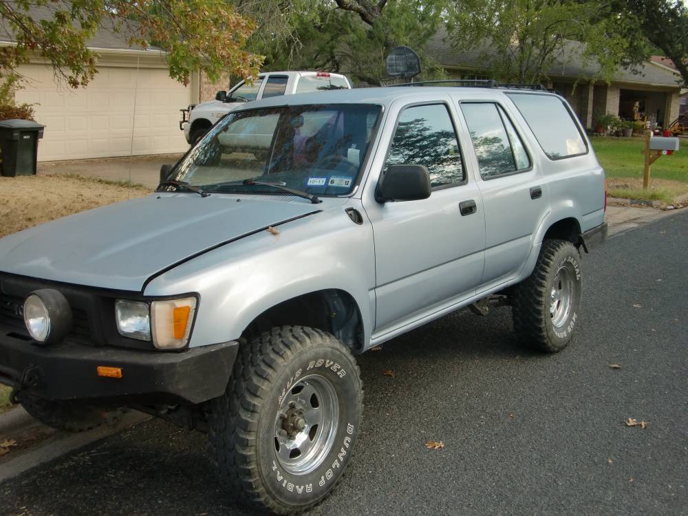

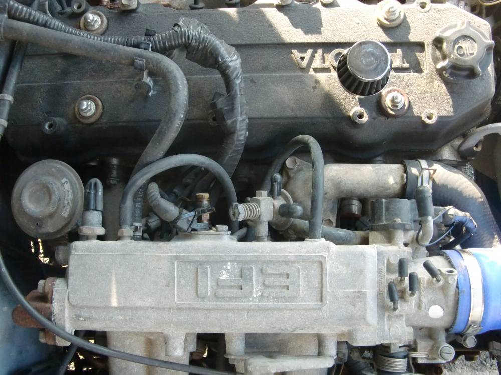

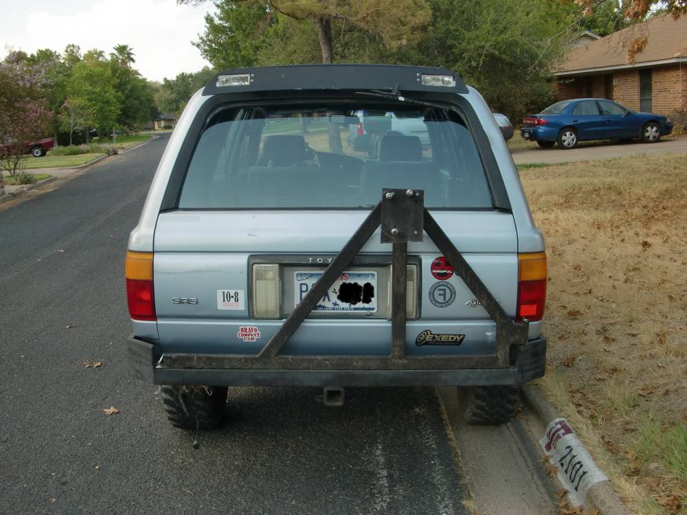

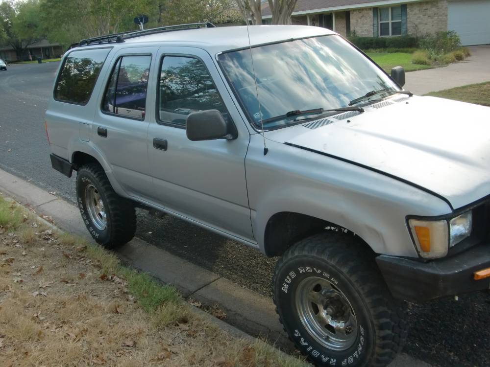

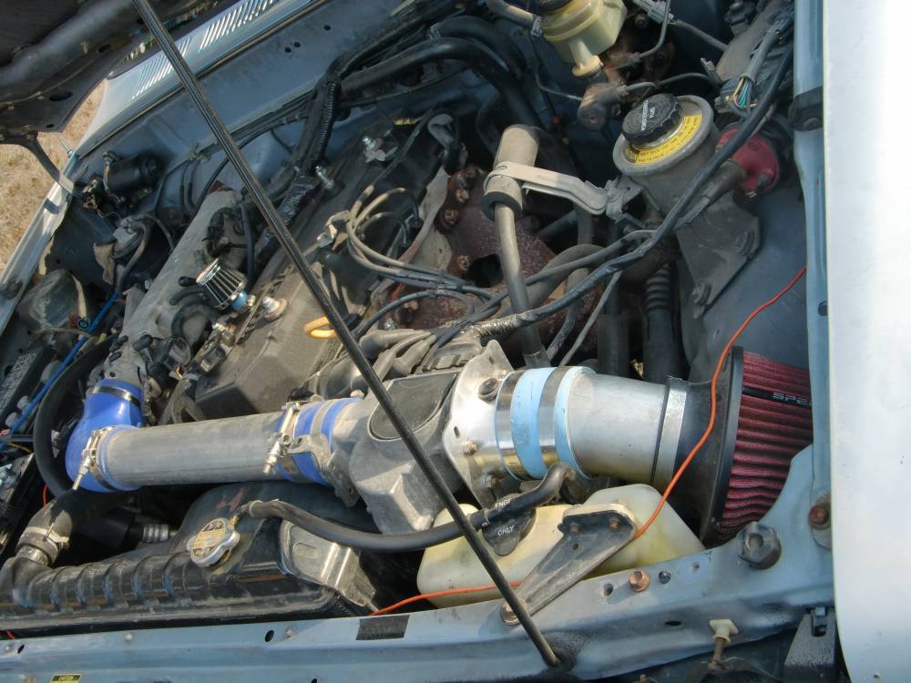

i attached some pictures including an up close shot of the intake manifold so if any of ya'll see somethin that doesn't look like its where it should be, lemme know.

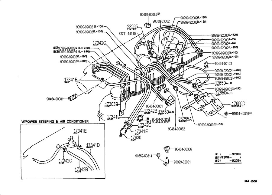

Search the forums using advanced search function, I use it all the time. Ton's of info is available, just have to look. I found the following link on either this site or Yotatech, whoever posted, thank you, been great for me. Has all the parts diagrams that the dealer uses, its a must have.
Toyota Wholesale Parts - OEM Factory Replacement Toyota Parts | Village Toyota Parts
Posted below is one of the diagrams I pulled for you.
