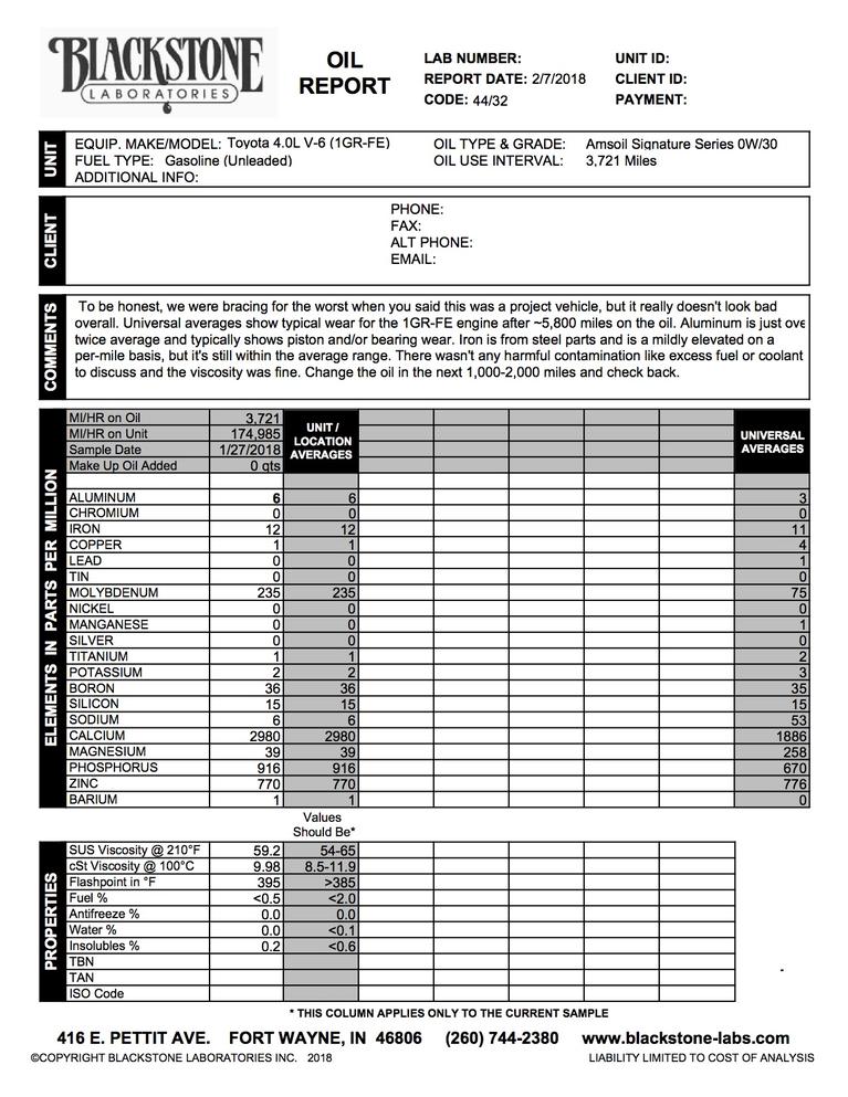

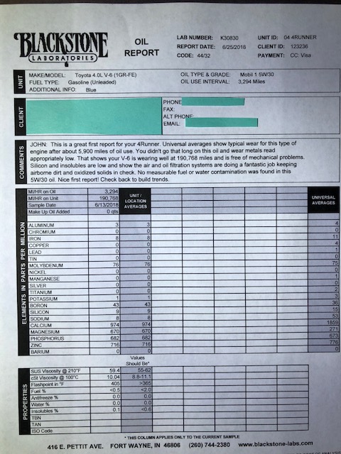

Hello everyone, just got my first uoa back on my truck. To be honest, I sent it in after reading all the horror stories on the head gasket going bad. I have no signs of it occurring on my truck, but thought the sample will tell me if there is a problem I'm not aware of yet regarding the HG. Will an oil sample show if there is any problem with the HG? Here is a copy of the sample I jsut got back. Thanks.

Thanks for posting, don't see too many UOA on the V6.
Results look pretty solid.
Generally you're looking for sodium and potassium numbers out of wack, beyond universal avgs for a head gasket leak. It will also show in the antifeeze % column, if they're testing for it.

Does this report's oil data contain any information that can be used to deduce your optimal oil change interval? If so, what does it imply about your next interval?
Yes it can, however I didn't have that particular test done, because I don't do extended change intervals, and it's an additional charge to have done. Down at the bottom of the report on the left side, you will see TBN. If you have that test done, it will tell you how much more life is in your oil at what mileage you did the sample at. It will tell you that you can either go longer on your next oil change, or you went to long.

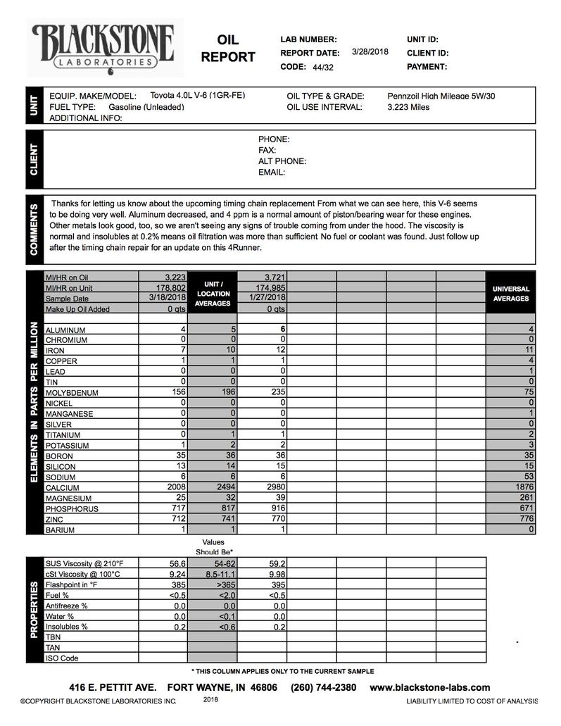

Here are two from my '07 4Runner:
