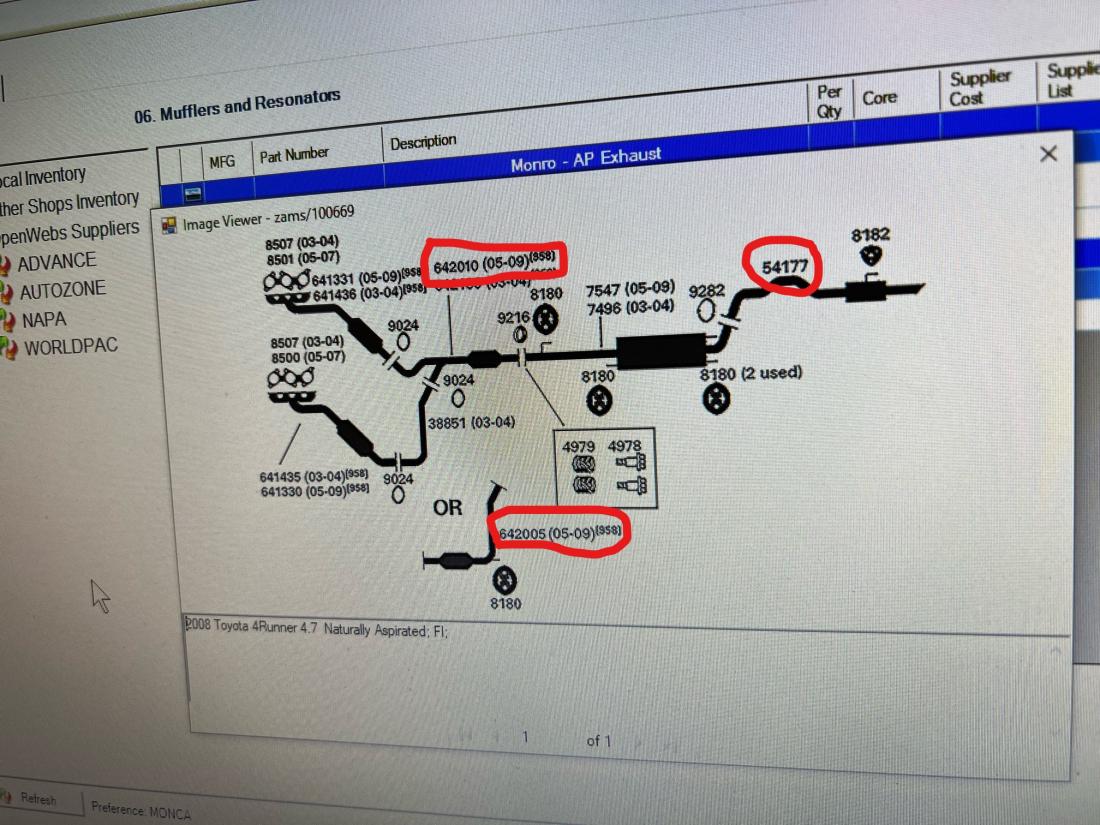

1. Based on the two attachments - did I add the right parts to my Rock Auto cart? One attachment is what I need, the other is my cart.
2. Is Eastern a fine brand to buy? It was one of only two brands I saw on Rock Auto, or should I be shopping elsewhere?
3. Are these allowable in NY, I think they are? The site is confusing about this.
4. Any rough estimate on hours of labor, and is there anything else I should proactively order or prepare for?
I'll of course bring the finalized cart back to the Monro manager before ordering, but I wanted your advice first on whether this is even a brand to go with and if I'm on the right track. If I can fix this all for roughly $1,000, I may do it for the peace of mind.

Yea, so presumably the rear catalytic converter is going to be the most difficult to replace.
A couple of thoughts
- Is your muffler in good shape where they said they could re-use the muffler?
There are some gaskets between the different pipe fittings so you may need to make sure what you buy comes with them or you buy them separately. Similarly, there are special exhaust bolts many of these will use - if they're in good shape, you may be able to use them.
Depending on how bad it looks, most of the exhaust stuff is pretty simple. - its just pipes fitted together Sometimes the O2 sensors can be a pain to get out and replace, so you could have the shop just do the cat converter and O2 sensors and you could try to do the rest to save you some money.
I think with NY if you have a Cat converter and are passing emissions you are all set
Depends how long you want the exhaust to last. I replaced my tailpipe with aftermarket and it only lasted 3 years. If that's enough then go for it. BTW, that Y-pipe is pricey and seems to mainly fail at the flanges. You may be able to have an exhaust specialist cut out the flanges and weld the pipes together so you keep the OEM y-pipe. The rear one is mainly a resonator so just keeps the noise down a bit. An exhaust guy may be able to make just a pipe for you that lasts longer than the aftermarket ones if you don't care about extra sound.

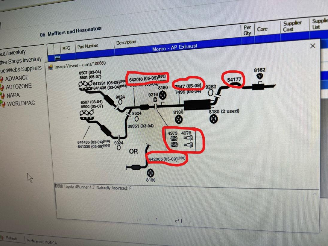

Well, the good news is all the parts came quickly and Monro Muffler only charged 1 hour of labor. We replaced everything with red circles in the attached pic (added in 7547 after the original post and talking with the manager at Monro Muffler).

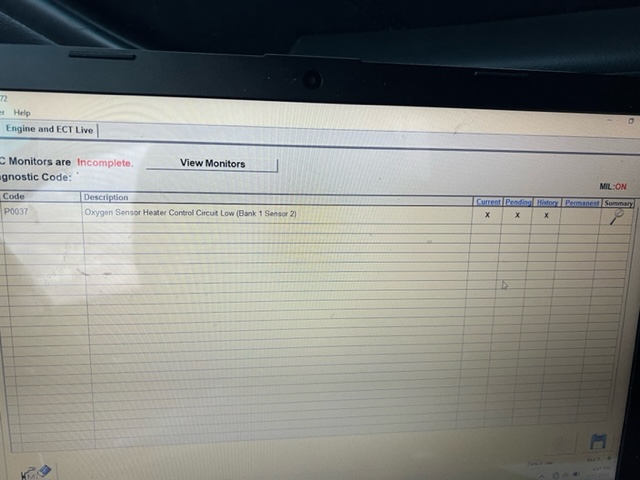

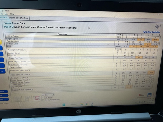

New problem: After the install, the 4Runner IMMEDIATELY began showing P0037 - Oxygen Sensor Heater Control Circuit Low (Bank 1, Sensor 2). I tried clearing it once with Techstream, but it immediately came back. I attached a bit of freeze frame data, no idea if it's the right info or not. The vehicle is at my normal mechanic for a rear blown brake line atm, so I only drove it about 3 miles once Monro was done with it.
Beyond frustrated, I can't win with the 4R lately, just replaced the intermediary steering shaft and left CV axle shaft last month too.
Any ideas on how to fix this P0037 code or what is causing it after the new exhaust install? Thank you in advance.

Its going to either be that youre not getting power to the O2 sensor - a wire rubbed through or you have a bad ground, or the sensor itself is bad
For a quick check to eliminate a bad sensor or wiring, swap sides of the sensor. If the code remains on the same side it's the wiring, if it changes, it's the sensor.
