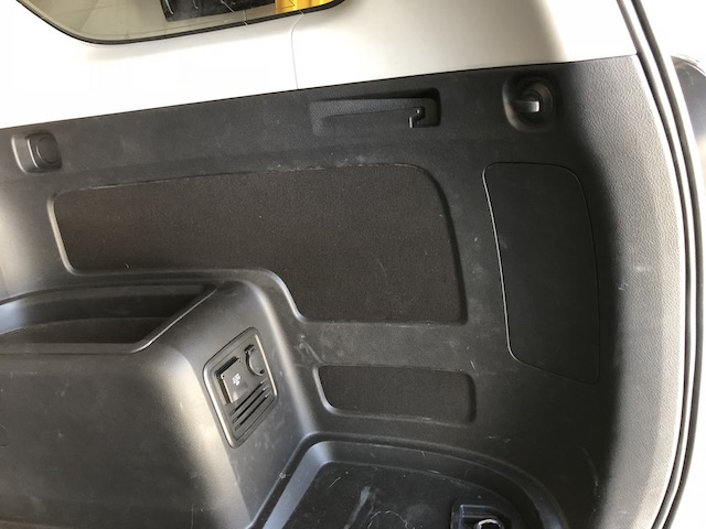

I'll snap a shot of my sub this afternoon. However, its not exciting. You can't see anything at all from the passenger bay. The audio guy at RSG lined the storage area with speaker cloth. This was key for me - as I've mentioned I'm extremely gun-shy about leaving non stock electronics visible in my car - and from the outside you can't tell anything is there.
You would have to pull the side panel off to see the work.

That is exactly my goal. Lets see it!

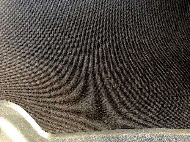

Sorry it took me a bit longer than I thought to post it.
The second photo was an attempt at showing the speaker through the cloth. You can almost see it in the center.
Overall I'm very pleased. I wished I hadn't lost the storage space but I'm currently building a storage system.
