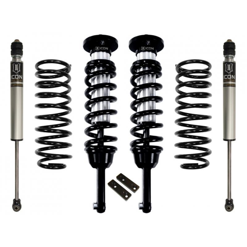

ICON is a great option and a step-up Daily Driver Comfort wise, as well as, Off-Road Performance.
Stage 1 (K53061) and Stage 2 (K53062T) are most popular for sure (digressive).
Stage 1 sounds like a great fit;
Depending on on the OME rear coils you have now, you may just want to order the
Coilovers (58646) and Rear shocks (56505).

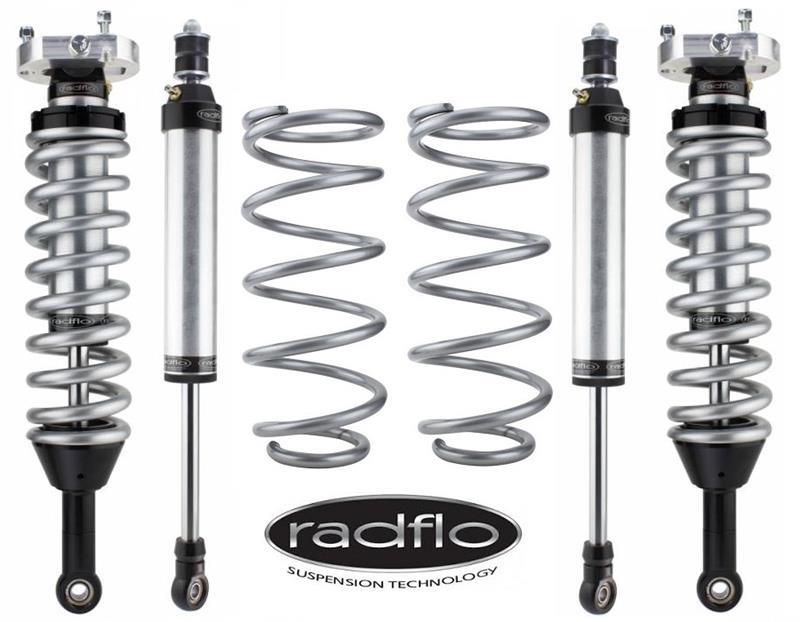

Radflo is certainly another great option, with choice of 2.0 and 2.5 Coilovers. Similar
performance to KING, but with more options (Progressive);

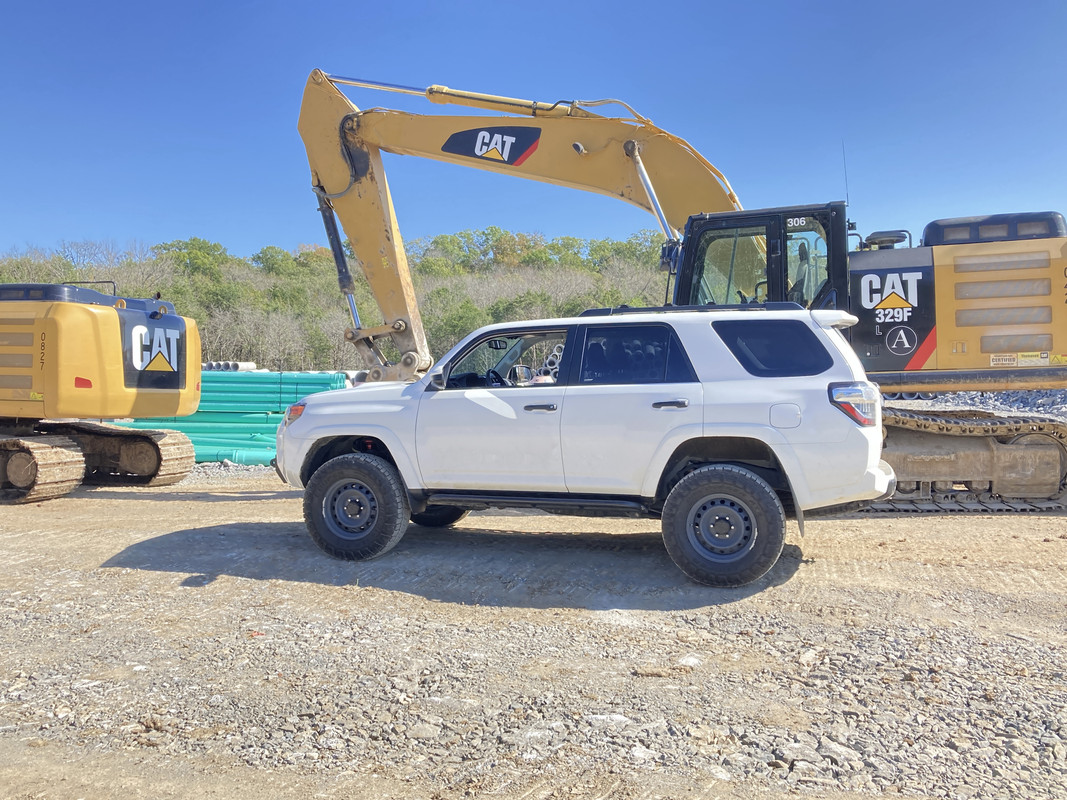

I like them - Prefer a more planted / firm ride and the 700lb Eibach coils that Elka uses pairs nicely. I've got weight upfront LFD skid (75lbs), warn hybrid bumper (88lbs), and a warn winch (60lbs).... so the springs are welcome.
Handles like the weight isn't there.
Explored a buddies development this morning - hit some "cut trails" through the property (old logging / farm trails) at speed today, really the first time for any 30mph+ off road driving as places to do so are rare in Middle TN. Handled great, wish we had more places for spirited off road driving.
