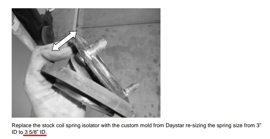

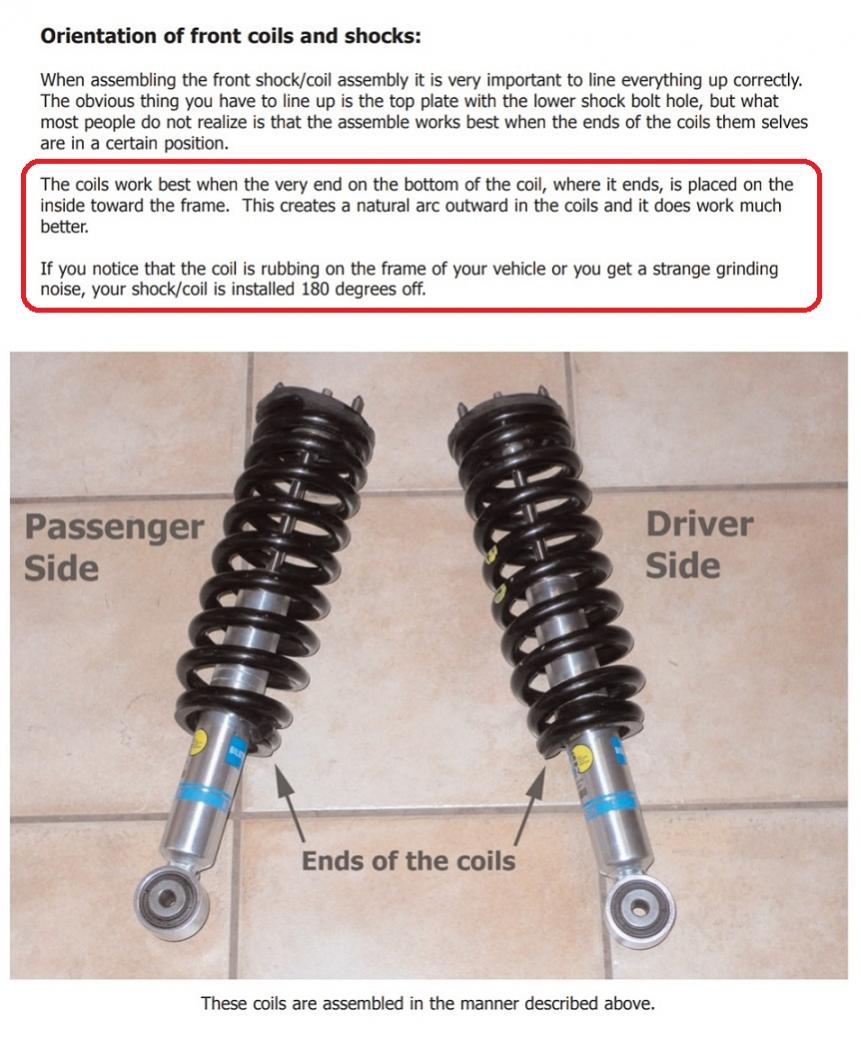

I think the coils rubbing that area of your UBJ/spindle is a little more common with the TRD Tundra coils because they are wider, 3 5/8" ID, than most aftermarket coils. SS install guide talks about having the bottom ends of the coils facing towards the frame to prevent this from happening. I don't know if it's actually supposed to prevent it or decrease the occurrence since this is something that has come up before with that combo. I've considered the TRD tundra coil/tundra 5100 because of the good things I've heard but the potential rubbing in this area was something I didn't want to deal with. If this wasn't happening before & it recently started you might want to contact Steve about it. I'd be curious to what he says.
I like SPC UCA for lifted 4runners mainly for the adjustability for tire clearance and alignment. I've had mine for 85K and still happy with them.

I found that even my OEM springs with 4Runner 5100's would interfere in some spring positions. You may be able to just rotate the spring to an orientation where it doesn't interfere.
