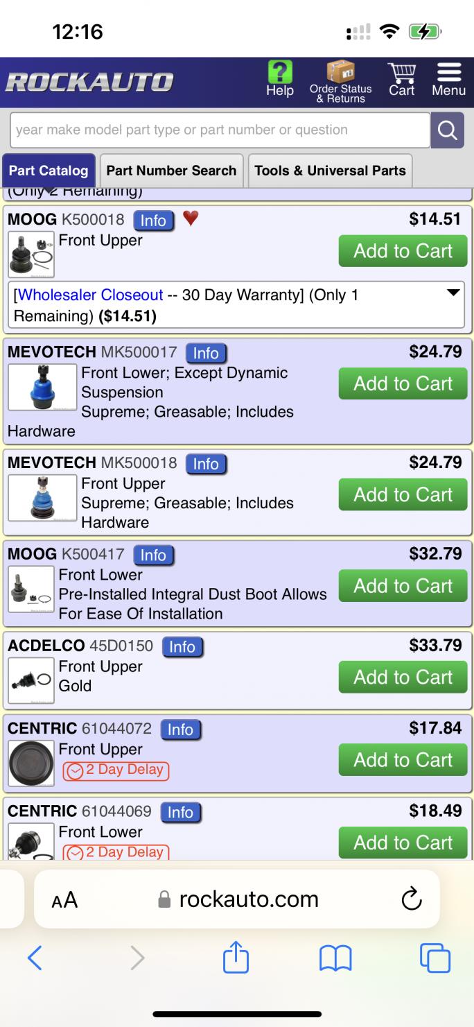

They sell replacement upper ball joints. They are a press to fit with C-Clip. Toyota just sells the complete UCA with ball joint. I have never rebooted a ball joint, but you can. Only do it if the grease has not been contaminated.
You can get the Toyota UCAs for cheaper than $300 online. Try Lithia Toyota Parts online.
You can absolutely rebuild the boot on a ball joint as long as the actual joint isn't damaged. I find it easiest to take the entire uca off and clean off old grease then regrease and install new boot. Re install the uca and good as new.
Thank you. This sounds like a good plan if I can’t find the replacement ball joints on my. I need to pull stuff apart to the the x-reas delete, so that would be the time to do this.
I would stick to ball joints by Moog, Mevotech (higher end version from Napa) and AC Delco.
