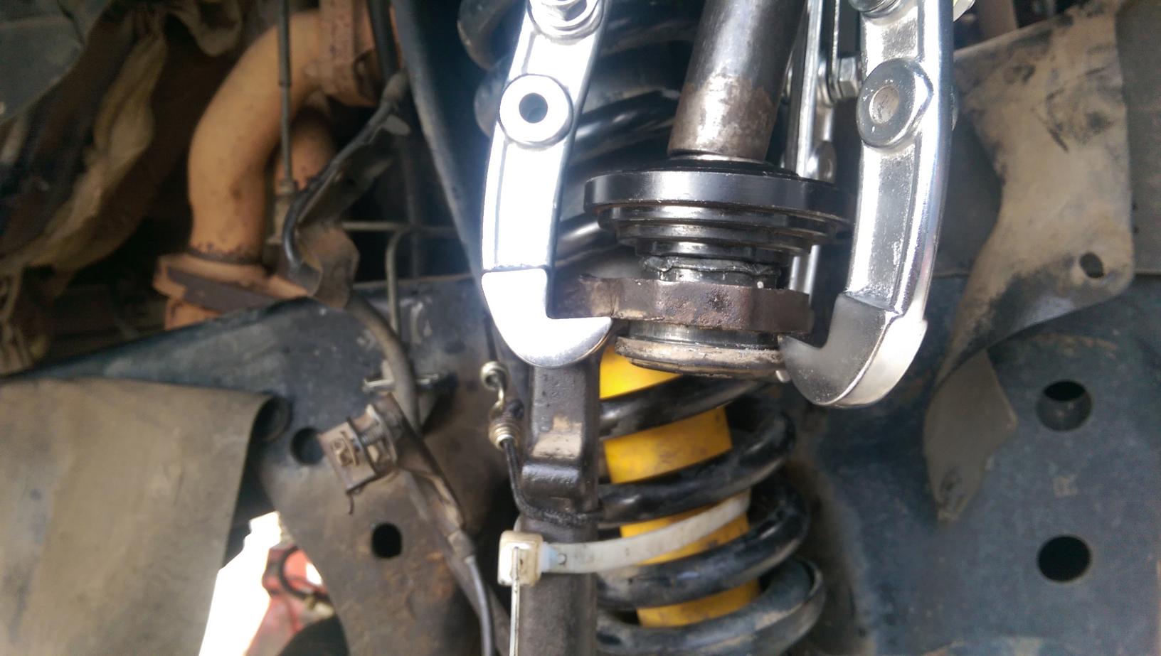

I have a ball joint puller and I cant get it in there to remove the upper. If you remove the hub you can but more PITA. I now use a 3 claw puller 8", knock or cut off the metal around the ball joint so a socket can fit over. I use a spacer from my ball joint kit then press it out. Still not fun. Now I have aftermarket UCA's so I dont have to deal with this ever again on my rig at least.

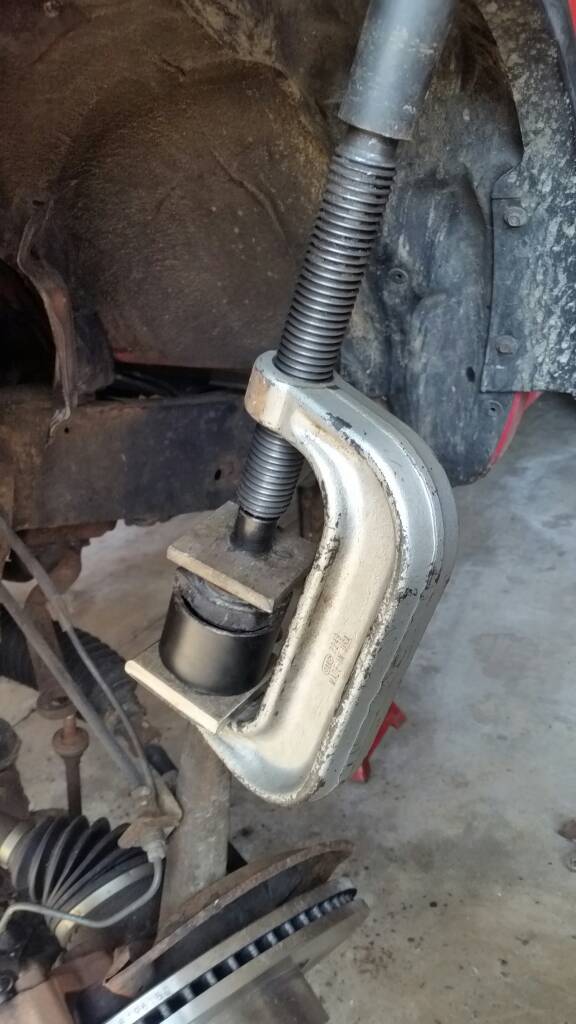

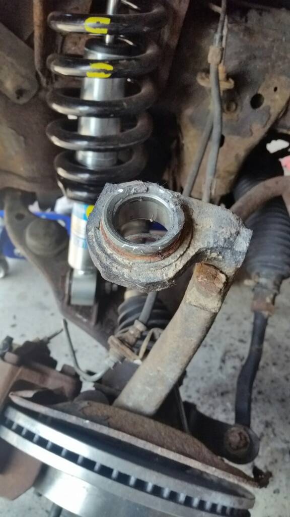

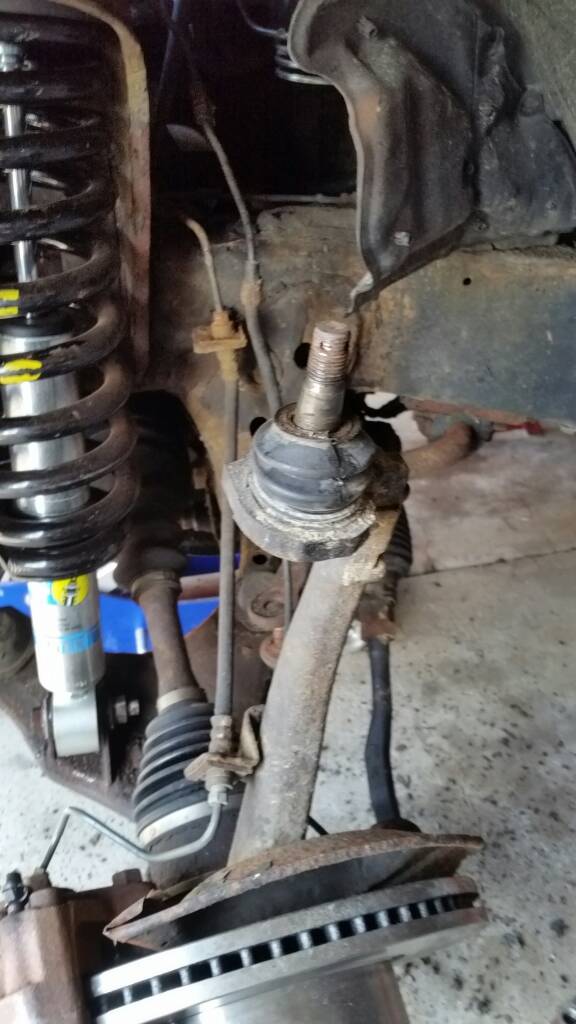

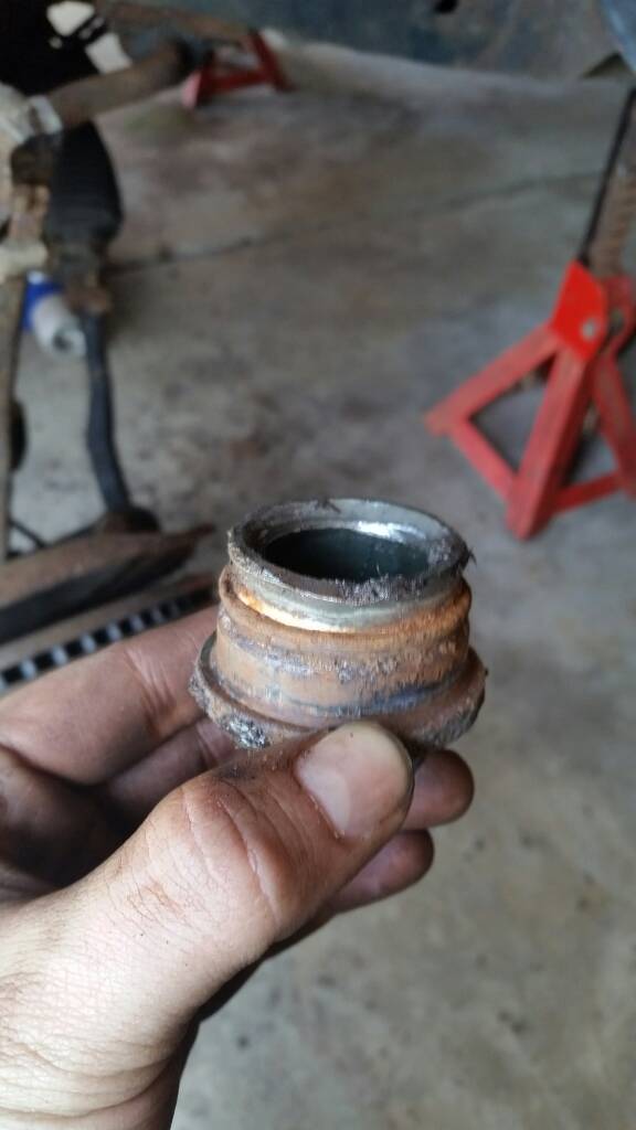

That claw puller thing was a nightmare for me. here's my method:
Pressing out the UBJ using the tools I had:

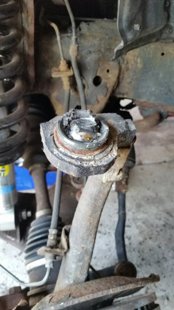

Cut and remove the boot AND SNAP RING
GRIND LIKE TONY HAWK

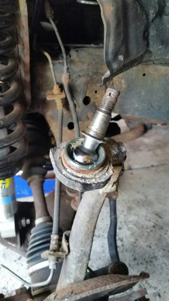

Press the eyeball section thing out
This is how my setup looked. I had to get some 2.5" squares of steel to press it out this way. The tool has to be used upside down (the one i used at least) otherwise the part you spin runs into the spindle and everything sucks. Also I got the square on the bottom, because the part that came with the kit to hold that black circle thing was big and fat and wouldn't fit.
God bless America.
Once I got it tight, I used my impact to blast it out

What's the point in putting a hole through the bottom of the UBJ?
If you take the clip off, you can press it right out, with no issues.
I COMPLETELTY get taking the stud off (see above write up), but it seems like you're making more work for yourself by pressing the ball out then the socket.
Just my $.02.
It just allowed my flat square steel thing to sit on the circular housing part, instead of the spherical ball joint. It only takes a minute to do. Could've gone without it, but it's just what worked for me
