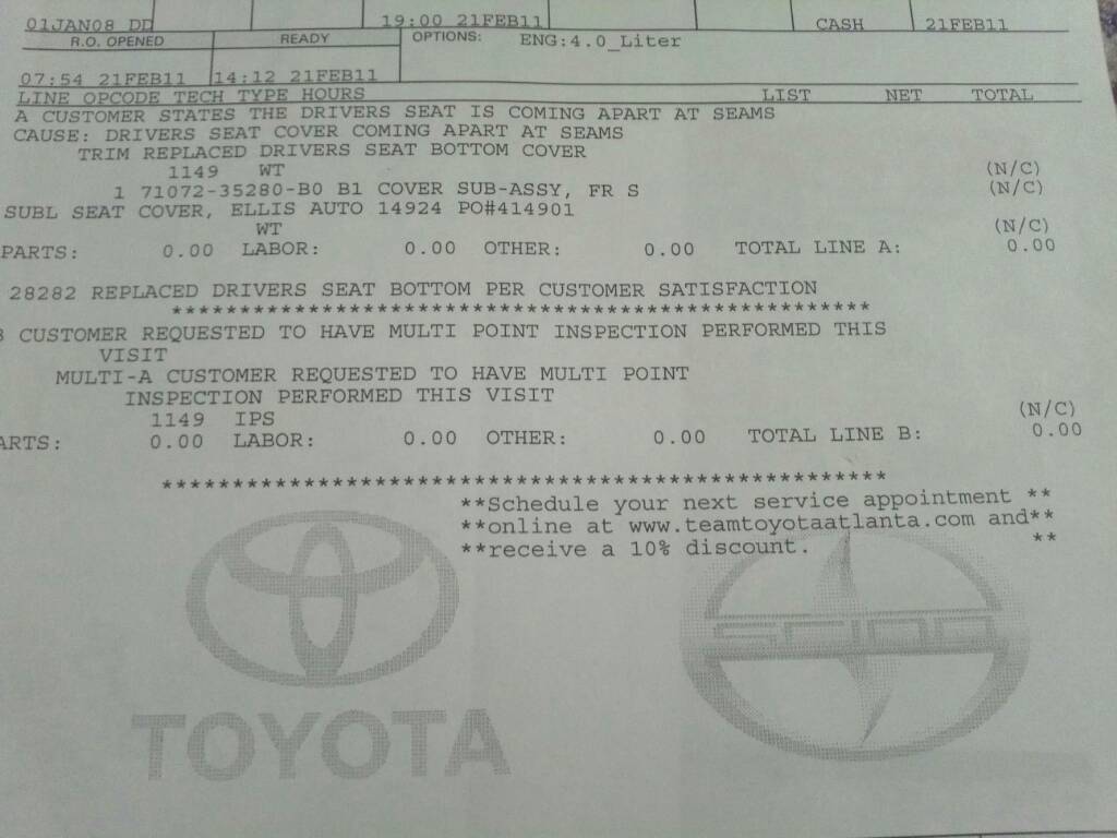

They've been known to tear slightly at the stitching on the lower seat bolster. Saw it more times than not on used urban runners when looking for mine. Toyota actually replaced mine AFTER I bought it used with 25k on it. (It was separating when I bought it) Of course I sent my beautiful girlfriend to the dealership with it so she could sweet talk the service writer. It was a $600+ repair. The dealerships will sub it out to a local upholstery shop. If you're gonna pay out of pocket I'd call your dealer and see if they'll tell you who does their upholstery and call them directly to see if they can repair it before ordering the lower seat cover. The part number for the cover is below. Another thing that helps is to NOT slide in and out of the seat.
