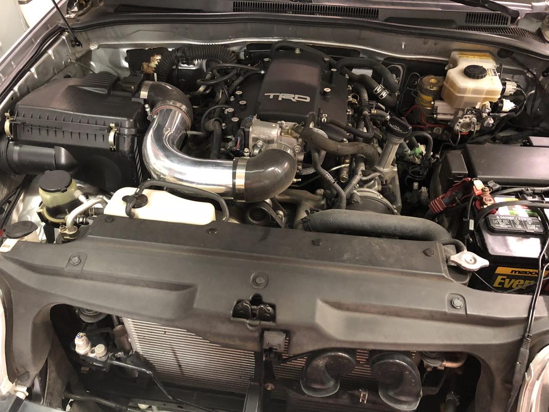

URD making a Supercharger kit for V8 4Runners!!
[MENTION=209958]Terminator03[/MENTION], [MENTION=155160]swampdodo[/MENTION]

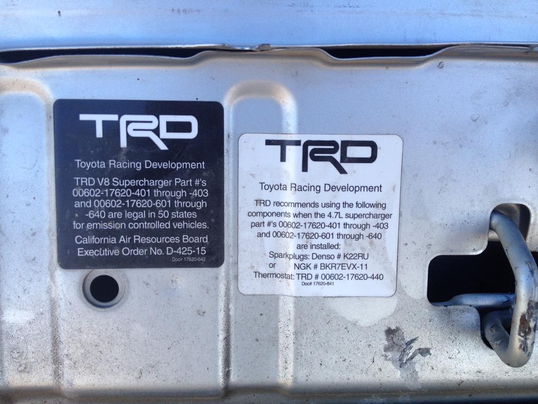

Not the original owner, I bought it wrecked and rebuilt the front so I don't know how it was installed, but from the Toyota history I think it was bought that way. Nothing shows that it was added later.
Planning to change power steering fluid this weekend while watching football and NASCAR in the garage. The brake fluid is clear. The picture was taken in the garage without the big lights on so it looks darker.

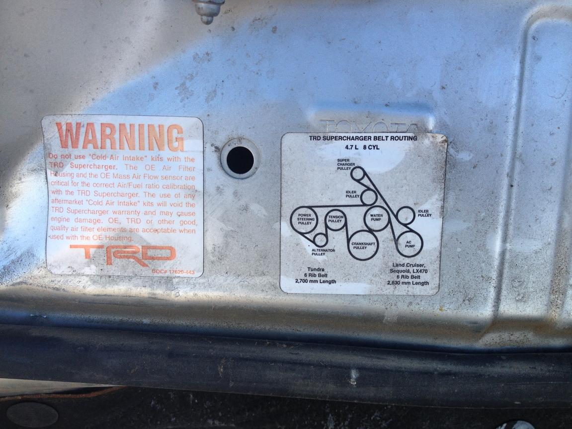

Here are the decals under the hood.
