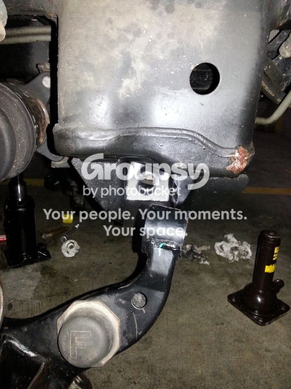

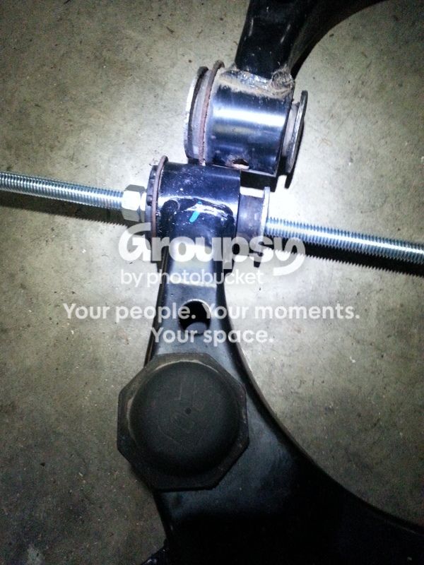

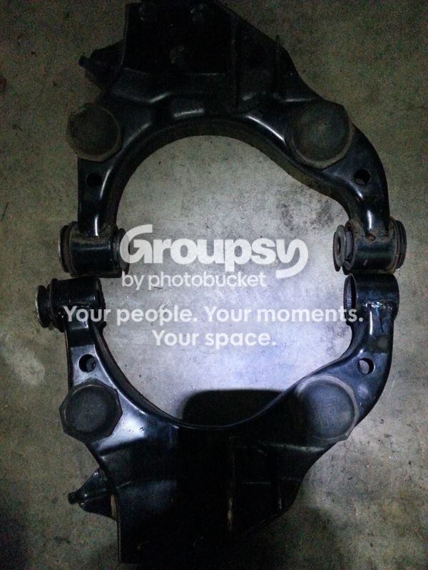

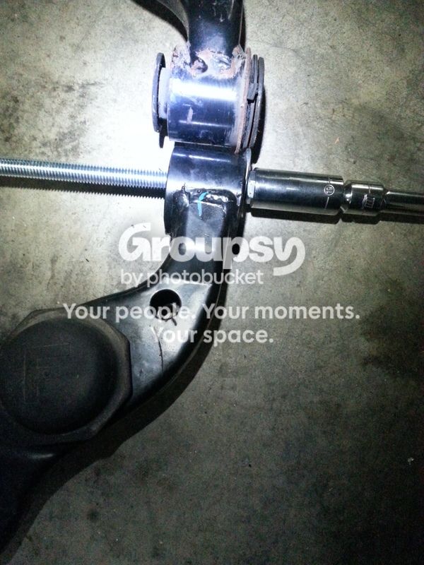

I removed my passenger lower control arm today to press out the bushings. The bushings were a huge pain, even using heat/torch and the bottle jack as many people have had success with.
Both bushings didn't budge so I added more heat to the area outside the bushing sleeve. I got one of the bushings out eventually, but the other one is still seized. I tapped the metal of the control arm to try to help break it free...
See pictures below... is this arm scrap now? I don't have a hydraulic press, and even if I did I don't know if it would go back to its original shape (and geometry)?
Help!

How did you manage that ? Damn I'm sorry man. Just order a new one ? I think they run for about $160-180 ish.
To be honest I have no idea... I guess the heat weakened the arm and the bottle jack deformed it...
I'm looking for new arms but the OEM ones are $235 here and I just bought the bushings and ball joints... bummer
Wow, that's something!
The good news is ,that barring a catastrophic event, the LCA on these vehicles don't fail. So you could get a used one from a junker/part-out and be confident that it would be serviceable. You already have the common replacement parts to go into it.

Just to close my thoughts...if I took it to a shop with a press, it is unlikely they could return it back to its original shape, correct?
I wonder if it is no-oem with lower quality steel ?
When I did my bushings, I watched the LCA bend and immediately stopped doing it that way. I ended up using a large drift pin punch and hammer. Took about 5 minutes for each bushing.
I would not try to bend it back. Plenty of used stuff out there for cheap.

so let me see if I have this right. you guys are using a bottle jack between the bushings to push them out?
honestly, I would be surprised it they didn't bend. that's a serious NO NO way of doing things. especially with that design of arm.
each side of the arm/bushing needs supported against whatever is being used to press the bushing out. that way all the pressure is on that one end, and not trying to force the ends away from each other.
