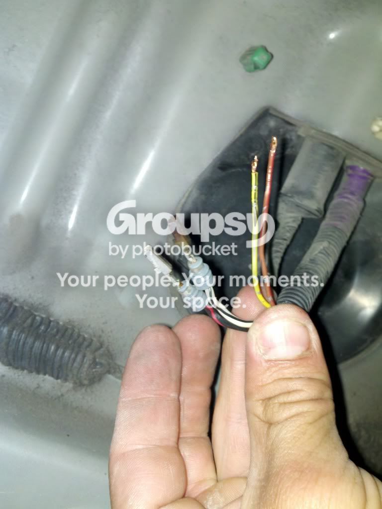

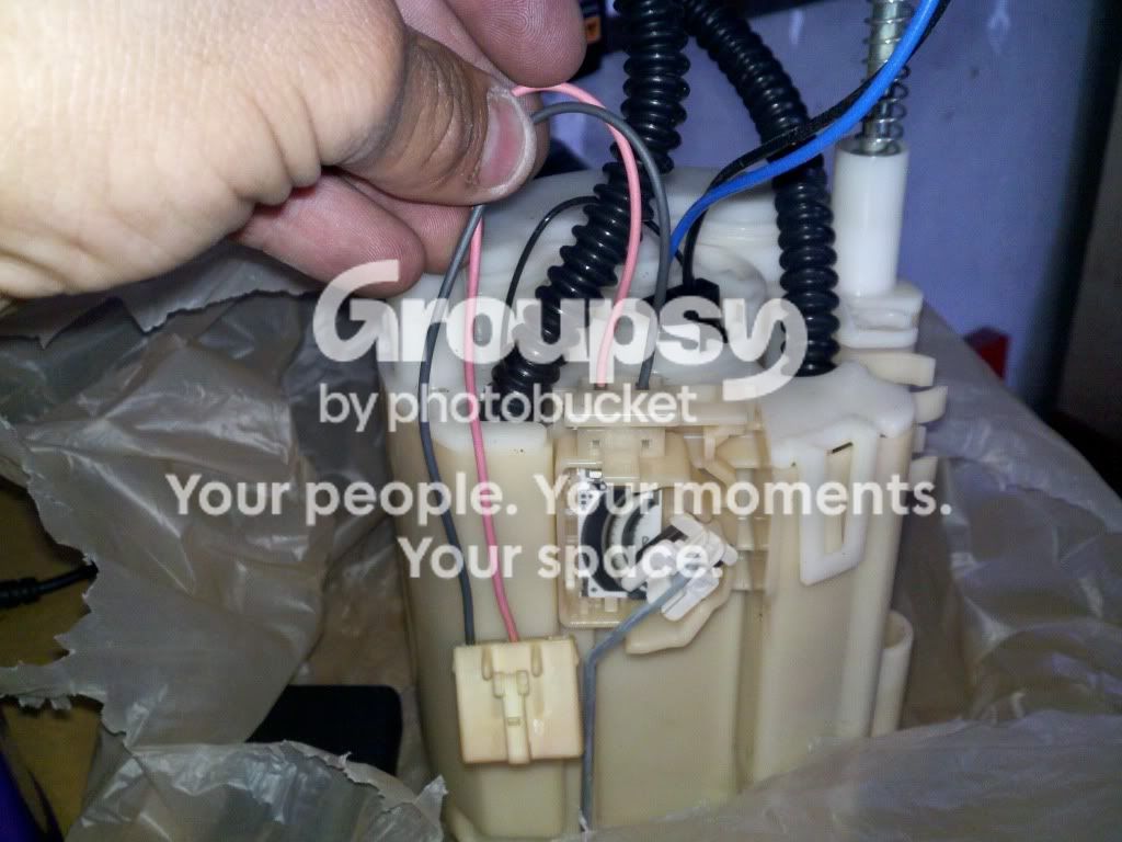

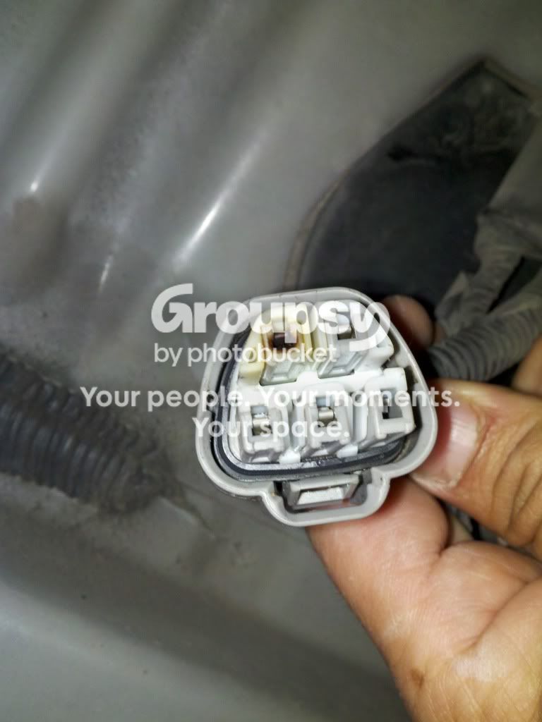

I decied to pull the tank. While taking the tank apart and out..I manage to break a connector (just pulled the wires out). Now im not sure where the plug back in. I will have to resolder them in place. They seem to be for the fuel gauge. If anyone can help here this would be awesome.
Bigger problem:

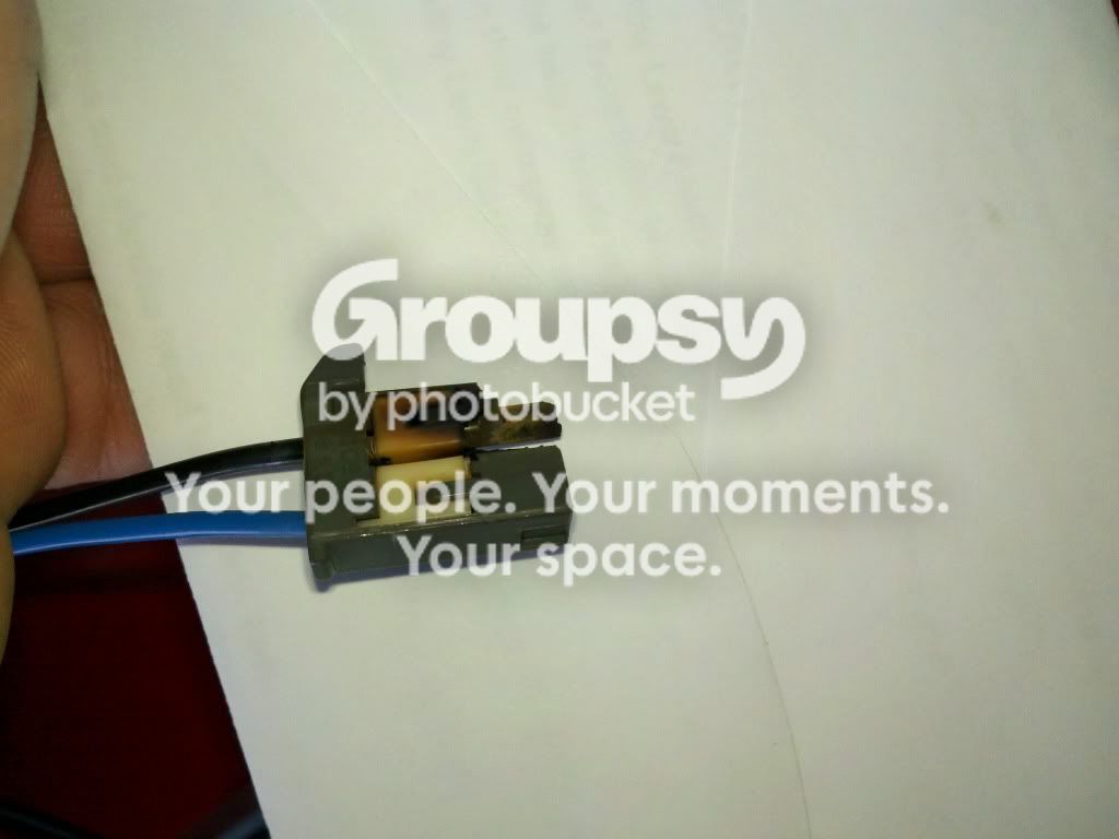

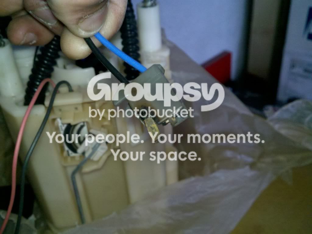

After taking the tank apart and pulling the fuel sending unit out to get at the fuel pump I notice that the connector I striped has a burn wire, connection. Very bad one and it made the plastic crumble it was burnt so badly. I have a new sending unit on the way from Toyota. Has anyone ever had this problem? Any helpful tips would be great. I have a Chiltons but the wire diagram doesnt break down this connector.
My guess would be red to red and black to yellow as for the ground? these two look like they work the fuel gauge and the other two are for the pump. Thanks

Thanks alot this will do wonders I hope. Not sure how this would have happend but now i have the assym on order $900. gotta do some wiring fix.
Dang a burnt connector next to the fuel tank is definitely scary. Good luck with the fix.
yea after i told the wife she freaked. It was actually inside the fuel tank in the fuel sending unit too. Luckily it was only a quarter tank full.
