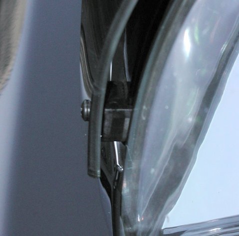

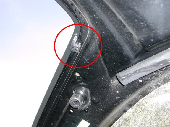

From memory, here's how the shield attaches:
1. You put six little pieces of clear "tape" on six spots along the hood's front edge. Its hard to describe the "tape" but it's clear, thicker than regular tape, and has adhesive on one side.
2. Then you slide six rubber pieces (shaped like the letter C) over the "tape". The tape protects the hood paint from the rubber "C" rubbing on the paint . You then tighten screws through the rubber "C" pieces on the underside of the hood edge to hold them in place.
3. Then you stick four (?) rubber bumpers to the top of the hood about 6 inches back from the edge. I was a little concerned about sticking things on my new 4runner's paint but it seems to be OK.
4. The front of the shield screws into the top of rubber "C" pieces and the back of the shield rests on the rubber bumpers.
Hope this explains the install. Hopefully the pics will help.
There's not much room between the hood and shield (around 1/4"), so I dont think much ice will get down there.
I though about that before buying it, but I realized they get a lot of ice in Canada, so it seem to reason they would have considered this - maybe the reason it sits so close to the hood. I used to have a US version on my 1994 Pickup and ice would get in between the hood and shield.
As far as washing, you could just unscrew the shield and remove it easily enough. But I would think repeated removal will loosen the screw holes over time. I just wash normally, making sure lots of suds and water run between the hood and shield. Then I take my Big Blue Towel (I love that thing) and feed it through between the hood and shield to remove water spots. There's just enough room to get it in between them.

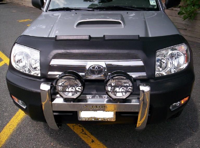

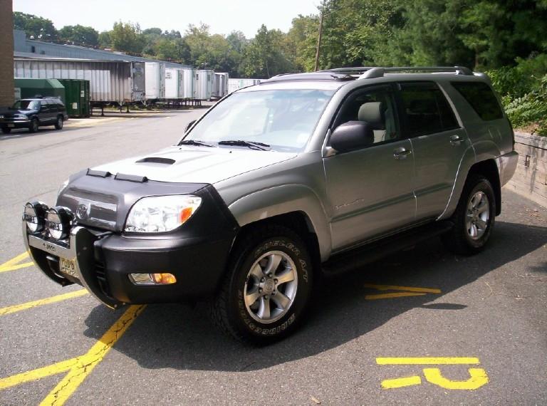

Heres how the bra would look like. Made by Colgan Customs. I also have the canadian version of the hood protector brand new never used. I'll be willing to sell it but you might have to pick it up because it will be to difficult to box up because of its size. Let me know...

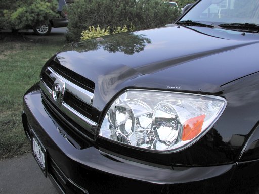

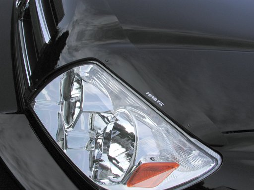

Here's a couple of pictures of the Canadian version. I've lightened the pics so they show the shield better. In "real life" its much darker.

wb2fcr, those are some really nice pics you took. Thank you very much. I really like the low profile of it. Does it completely cover the hood right about the grille area? That seems to be where I keep getting the chips. It is hard to tell from the pics if it goes under the hood a little or just right down to it. Either way I think I would be covered. Again thanks for the awesome pics, it does look great!! I think I am sold on the Canadian model...
It goes right down to the top of the grill.... protecting it good. I highly recommend it. If you have a black vehicle.. it'll blend right in!
I echo iFORCE's comments...
It protects the hood nicely, especially the painted part of the hood between the grill and headlight. It molds right along the hood. I didn't want a butt ugly wing on the front of my 4Runner. And I really like the way it blends in with the black color.
