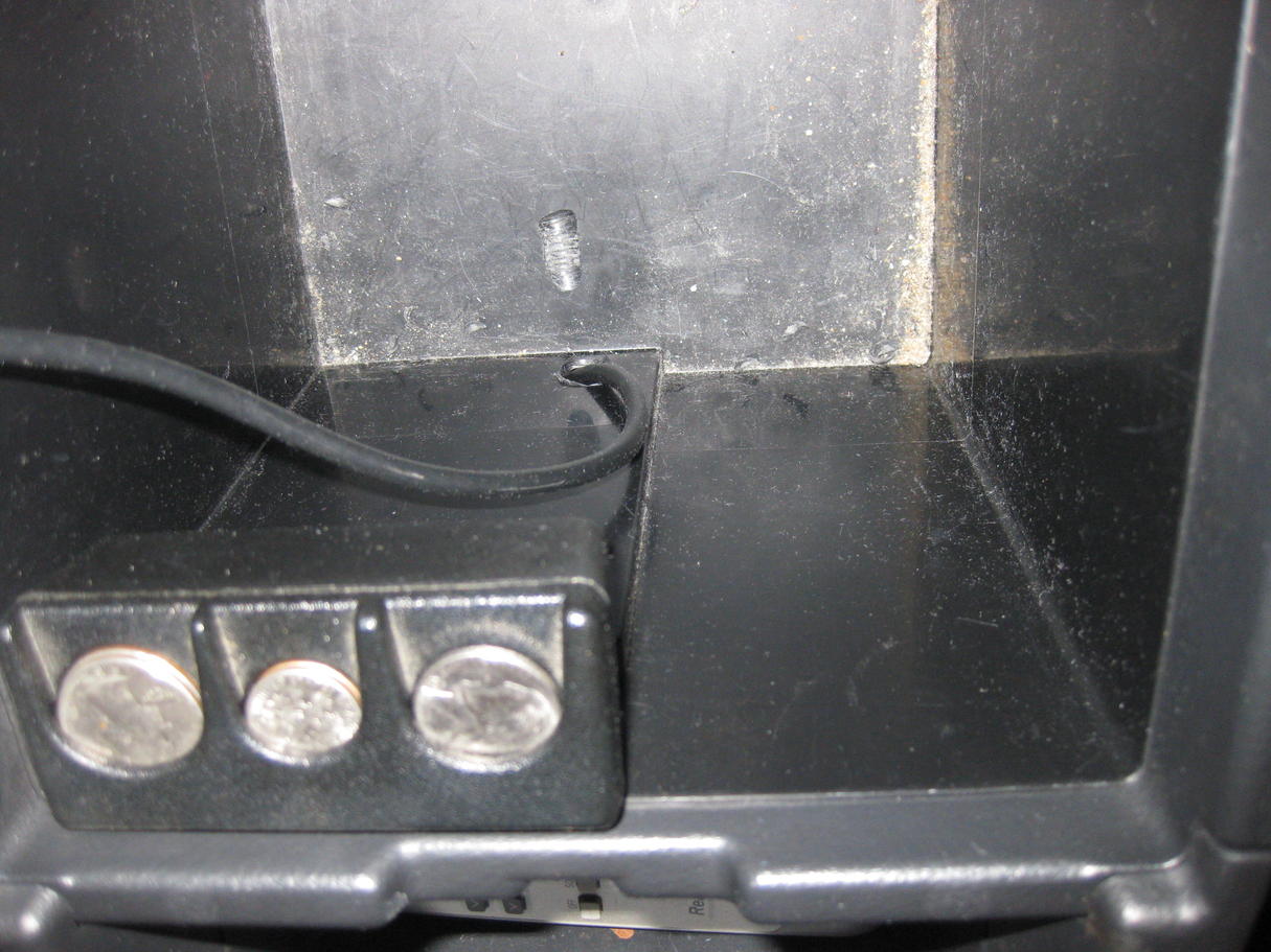

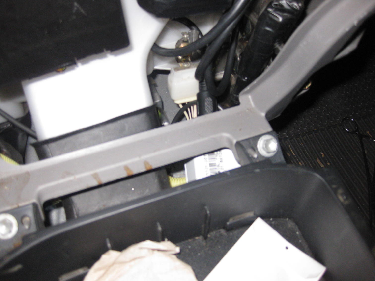

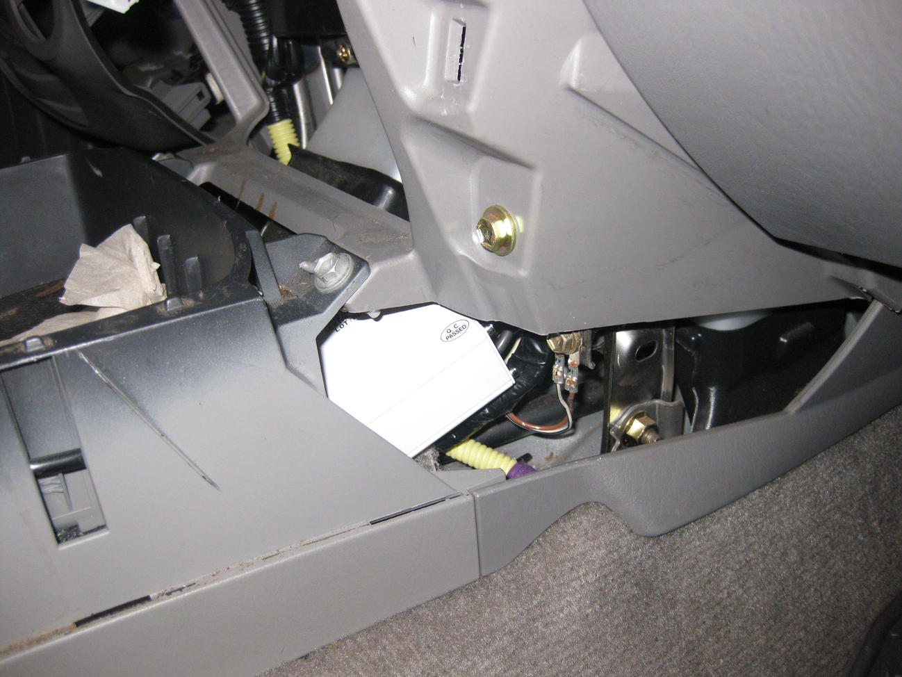

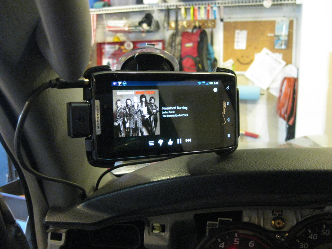

Done! I put the unit below the pop-out drawer and in front of the shifter and ran the Ipod cord into the center console. Scuffed the inside bottom of the console with the drill bit trying to widen the hole a little but everything went smooth otherwise.

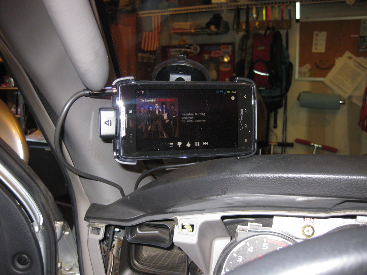

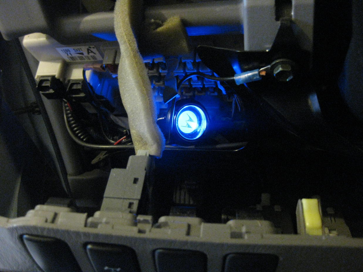

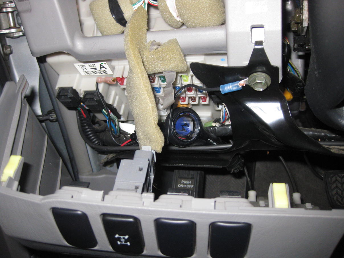

Also ran the AUX cable up to my Droid RAZR mount. Now it has power and internet(Pandora)! I can also do hands-free calling, it comes out through the speakers and the mic is in the perfect position for me to talk into. I'm pretty happy about the whole set-up.
In the pics are where I put the unit, the power winshield mount with AUX run to it, the hardwired Motorola charger, and the Ipod cable in the center console.
