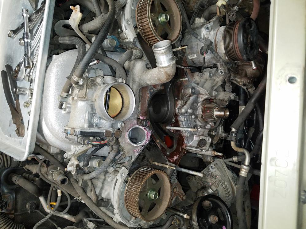

I would still do a fluid exchange on your transmission. I would also change transfer case fluids and differential fluids. As far as coolant loss, look on top of the engine behind where the thermostat is. The stat housing has connection in the back that is just an o-ring seal. it is not uncommon for those to leak. You will see a pinkish white residue or crust forming and that is a good chance where your fluid loss is. The picture is from when I did my timing belt a few weeks ago, but you will notice the leak I had just left of the air intake by the right cam shaft wheel. Sorry that picture is sideways.

You can also look closely at the radiator for any pink crusty deposits forming, especially at the corners areas and if you find any it's sure sign of it leaking coolant and should be replaced at some point.
