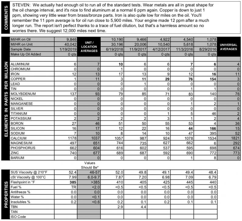

I've been running Mobil 1 AFE 0W20. On this last oil change, I switched to Amsoil Signature 0W20 (and on the 50k oil change I'll have them run TBN for me).
Here is my latest Blackstone report.

Thanks. That report is with the Mobile 1 correct? I'd be very interested in seeing your results when you test the Amsoil.
Yes, that is the used Mobil 1 0W20 AFE in my latest sample.
I will certainly post my UOA results when I hit 50k. I figure my OCD nature might as well benefit the other T4R owners/drivers here. :D

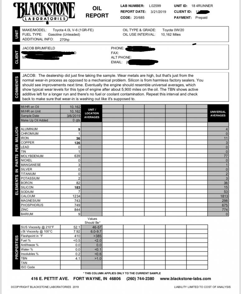

For what it’s worth here is my oil report on first oil change at 10,000 miles
