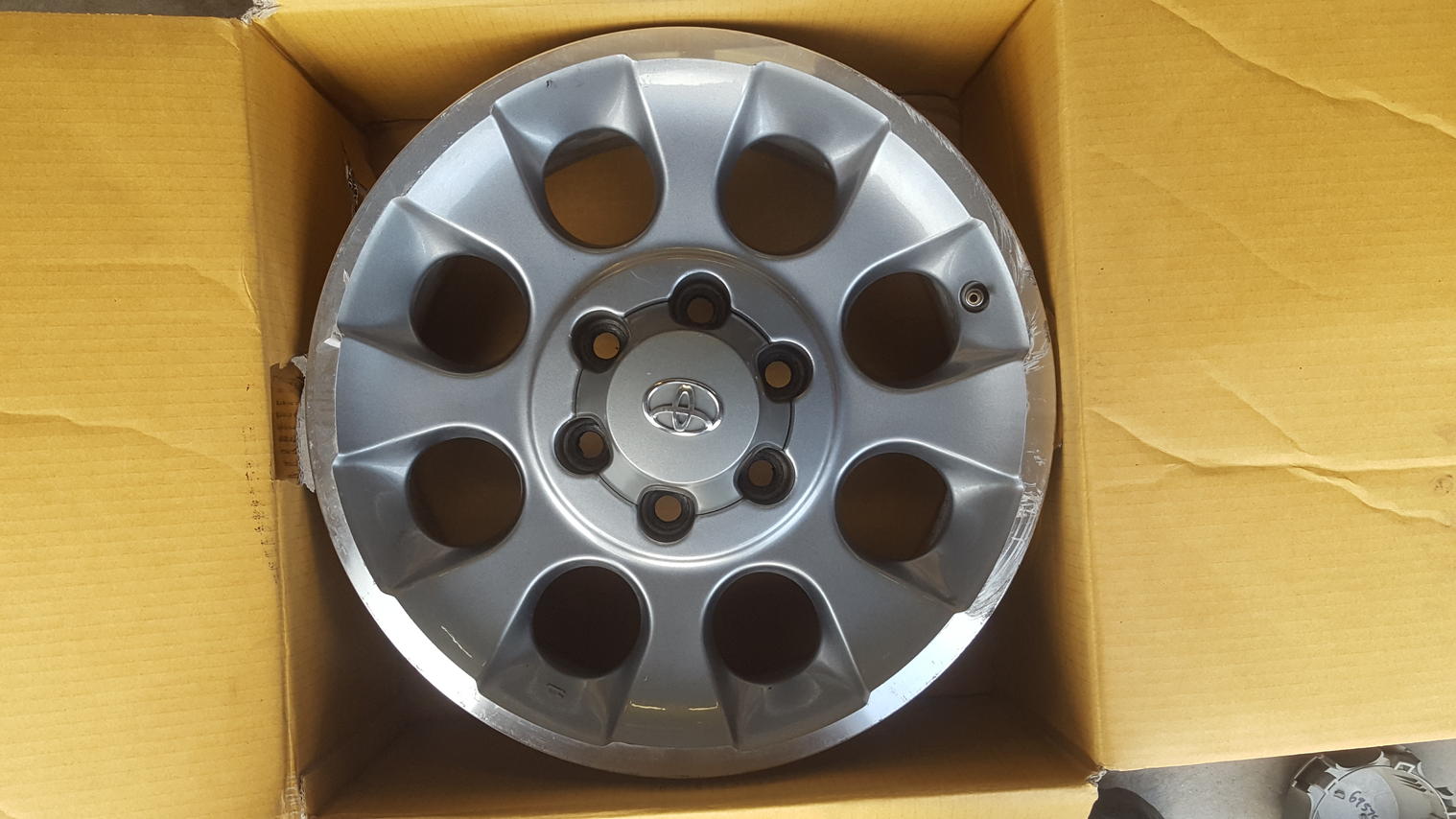

I have a set of FJ wheels that are the same as the 10-13 Trail but in a darker argent color. They have some rock rash but does not affect the function of the wheels.
The wheels are 17x7.5 and will 100% bolt on your T4R.
PM me if you're interested.
