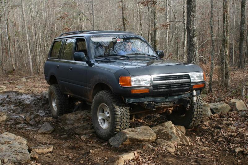

im getting a pic or two to post for you non-believers

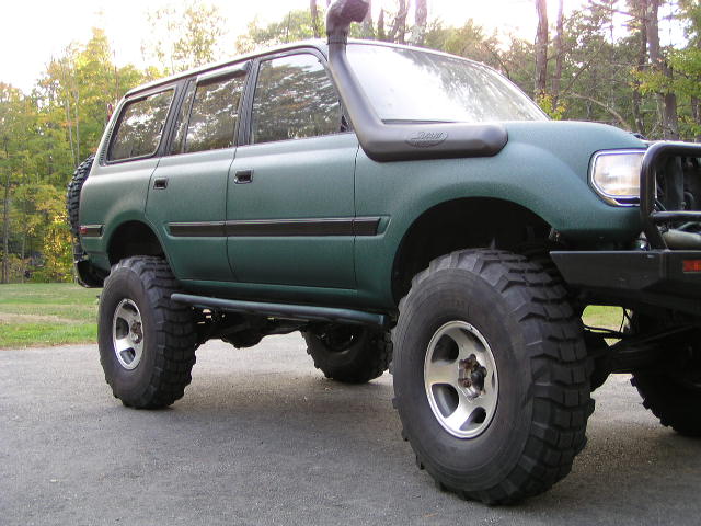

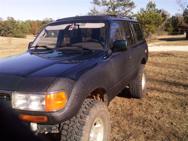

Here's a couple 80s. the first 2 being mine.

Everybody that saw mine in person loved it...it looked professionally done and trust me I have no professional bedlining skills. Thats Upol on all 3 pics in post 7. I need to clear this up. I didn't spray the 3rd pic. It was done by the owner.
Also the best thing to keep it from fading is to paint it. Everything on my 4runner now that I bedlined looks great 9 months after spay painting the color of my choice.
However, like the kid said, I believe a shop spraying it would possibly be a little more durable but what I sprayed on my 4runner is holding up fine.
like i said im sure it can be done... just havent seen one (till now that is a good job) -looks great, i would of thought it was a professional job :trophy:
2011-04-21_11-30-39_70.jpg~original
2011-04-21_11-30-29_989.jpg~original
keep in mind, its a little faded and has never been washed. this was done for functionality not too look cool . . .
