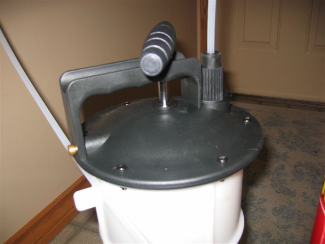

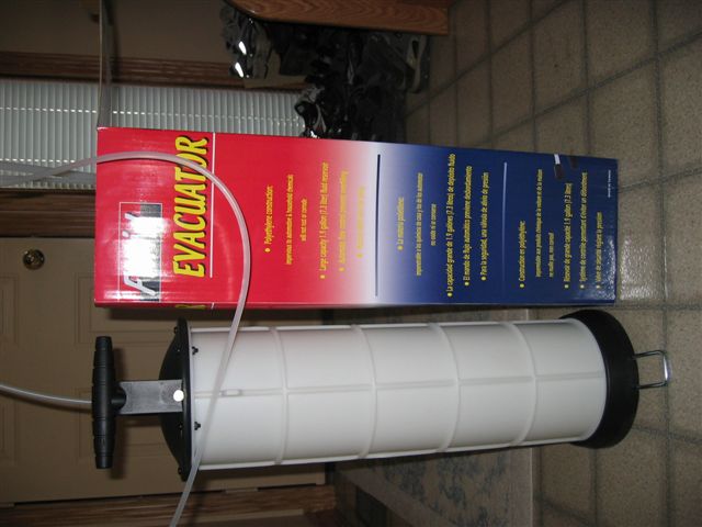

Just picked up a 'fluid evacuator' for $50 Cdn. I hope to use this with the '03 V6.
What is the proper use of this device? Do I pump first to create a vacuum? Do I just run the tube down the dipstick and start pumping? What about once the unit is full...can I pump the used oil out into a different container?
Will this collect all of the oil? Or at least do an equivalent job to a drain plug?
Thanks, I'd rather have a clue before I start.

I bought the unit at "Princess Auto". I think they are Canadian only. Others have purchased from Griots garage I think.
It is probably very easy to use, I will probably 'test' it out on my snowthrower or lawn mower before doing the Runner.
It looks like it has a spout for pouring used fluid out.
I also worry if I am going to risk 'mixing' any fluids? ...say I extract old gas, then want to do an oil change...any thing to worry about?
J
