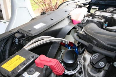

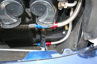

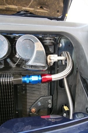

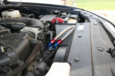

Any pics of the install? If you did an install post just give me a link. Is the cooler like a trans cooler (in front of the A/C condenser)?
Yeah, that post is in progress…like a goof I took pics of the install then decided to send my camera out to be cleaned with the memory card still in it. Do’h.
Anyway, I just got my camera back so here are some pics of the oil cooler.

:jaw drop: That is a super-sweet install! I am totally jelous:thumb3:
