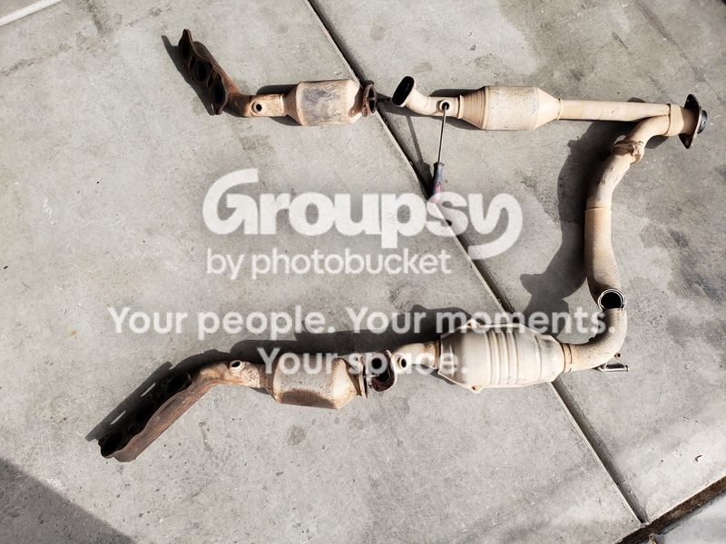

I don’t think so, only because the LT headers delete the first set of cats, and the Y pipe deletes the second set. I don’t know if I want to run without any cats at all.
I’m assuming you have an O2 sim? How does that work if you’ve deleted all 4 cats? I thought the sim ran off of the second set of cats? I just haven’t looked into it that in depth yet.
The downstream o2 sensors are placed before the secondary cats. So the rear o2 simulator is only necessary if you remove primary cats. Secondary set is behind the rear o2's and not monitored.

See pic. Screwdriver indicates 2nd set of O2 sensors. They require a sim. You can change y pipe with no issues. If you do headers that remove the front cats you will need to install a sim. In the o2 sensors that reside in the Ypipe.
