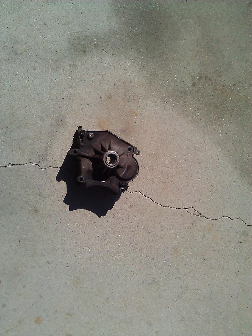

yesterday my fan pulley went out and since i am predomanantly a ford man, I assumed it was the water pump, well it turned out to be the fan pulley hub assembly. anyone have one or know of a source to find one. this is for the 3.0 v6 on a 94 engine. or are these parts rebuildable? Thanks in advance.
I just had the same part go out in ny 90 runner with the 3.0 in it I found 2 one was $3.80 and the other one was $280. These prices could be different in other parts of the country.
The mechanic found them for me here locally he is fixing that plus the timing belt which looks like it was the original belt with 220,000 miles on it my timing was off by one tooth re**** and he us replacing the water pump new cap and rotor new belts new cam bearings and the fan hub bearing.
He probably found it at napa or carquest.
