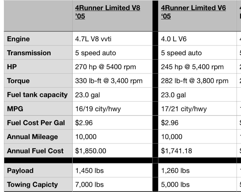

For me it was 05 and up V8 or V6. Happy I found a clean V8. Here’s a spreadsheet I made that helped me during my search.

You are a WAY more organized person than me. Lol I appreciate the spreadsheet.
