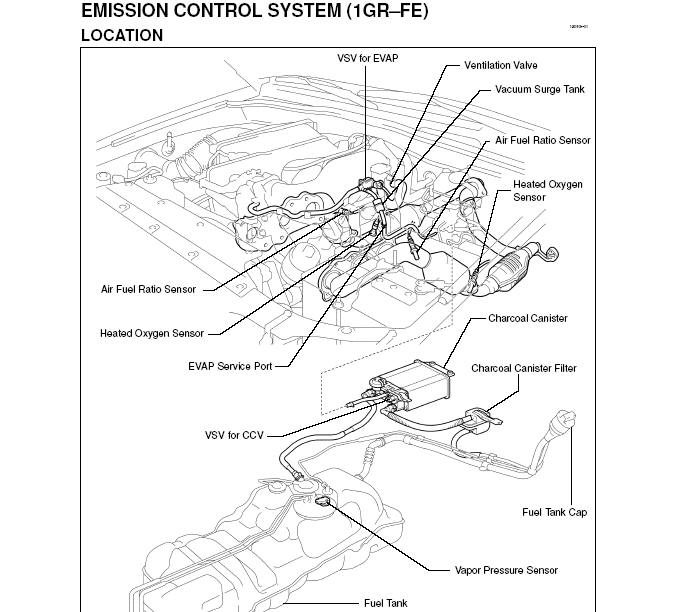

Does anyone know where the PCV valve is located on the 4.0L V6? I would like to replace it, but I haven't noticed where it is located. I'm guessing that I may need to remove the plastic cover over the engine to find it.
I think Toyota uses a term other than PCV valve. Does anyone know what they call it or have a part number? Thanks.

It's called a "ventilation valve":

John,
Thanks for the great diagram. That makes it real easy.

John,
Where did you find the diagram, from a shop manual ?

Yep. Got it on eBay. There are a number of other threads that discuss getting the manuals. Unfortunately, neither Haynes nor Chilton have one yet.

My vent valve (PCV valve) isn't working properly and I can't find it under the hood. the attached diagram isn't much help for me to locate it. Sorry!!
can some take a picture of it and circle it for me... please.
The diagram isn't available anymore, but I see the picture. How easy is this to swap? The stealership wanted quite a bit to change this out and said it was something they recommended since I was at just over 80k miles.
Replaced the PCV valve on my 2007 Toyota 4Runner Limited 4x4, V6 with 75600 miles today. PCV (Positive Crankcase Ventilation) valve is located in the rear of the engine on driver's side. You will need a 19mm deep socket with an extension and something to cover your fender from scratching. Factory PCV valve is in there pretty tight so it was little challenging but, it took me about 15 minutes, cost of the PCV valve is $6.50(ebay). and it actually made the engine sound smoother and it feels good about having it done.
