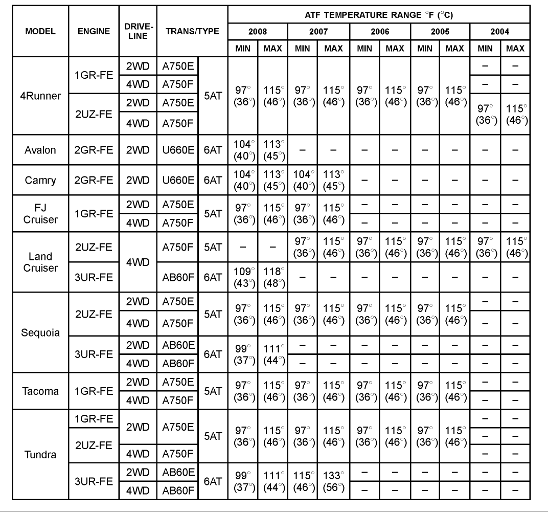

I just changed the filter in a 2006 V6 and wanted to share a few notes, since I found so much helpful info on this site. As the OP indicates, this is an easy job on this era V6, as there is NOTHING in the way of the pan!
I did not do a full flush - only refilled what was lost using the workshop manual's procedure. I also used the $10 OBD Fusion iOS app connected to a generic OBD2 module and custom PIDs to monitor the fluid temperature during the fill procedure. I actually forked over the extra $10 for the 2006 Toyota extension pack, but alas, it did not include the ATF temp. Fortunately, I found the custom PID info elsewhere on this site (repeated here to be complete).

- TSB 0129-08 alters the temperature range at which to inspect the fluid level (see attached chart). The updated range for the 5 speed automatic is 36-46 degrees C (was 46 to something higher). In my case, the temperature topped-out at 41 degrees C idling.
