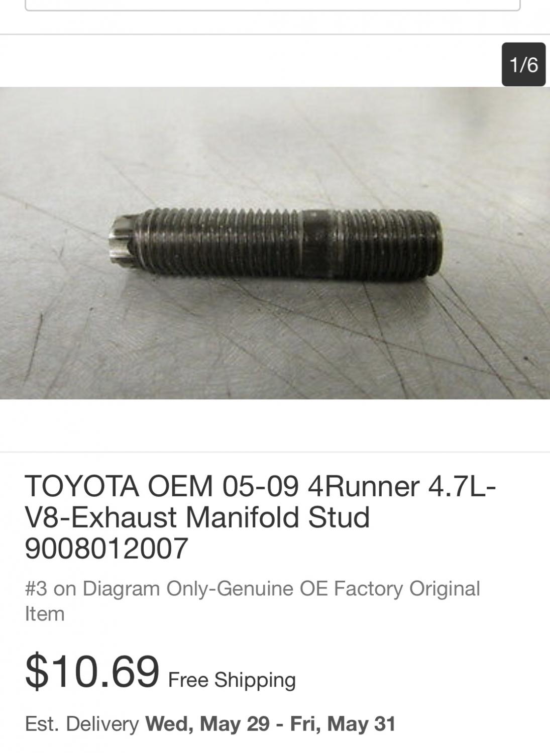

I wonder if the inboard thread is 1.5 distal to the broach... and the outboard thread is 1.25. Which could be why I’m hearing different info. Take a look at the following pic. Could be the angle but the threads do look a bit different.
I will know soon enough. Will obtain a genuine stud and update this thread... pun intended

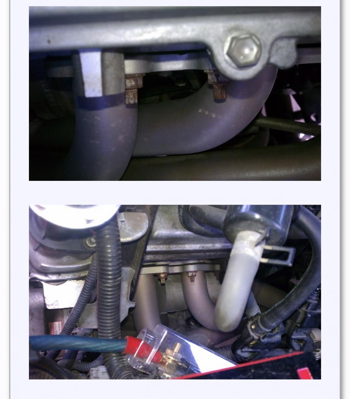

Exact ones that I used on my DT setup. No issue....

Obtained an OEM stud last night.
OEM 4.7L stud is 10M 1.25 x 40mm length. Confirmed. Inboard and outboard threads are the same.

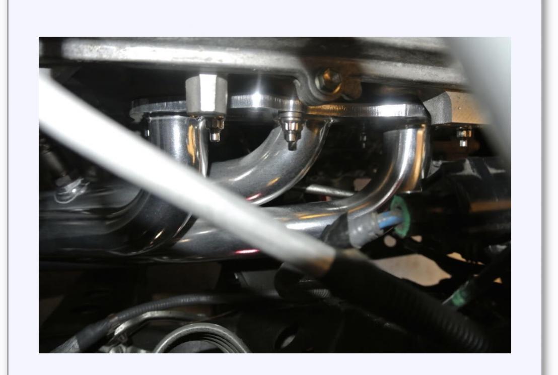

If anyone is interested, the following ARP stainless exhaust manifold kit *should* work with DT headers. Obviously don’t know for certain and would need to test fit as the broach is bigger than stock, (DT header flange is 3/8”), and the overall stud length is 8mm longer.
ARP Stainless Steel Accessory Studs 400-8036 - Free Shipping on Orders Over $99 at Summit Racing
Pics before and after install of ARP studs with DT headers on a 1GR Tacoma below. Something to consider if you are already going to be elbow deep in a shitty header install anyway. This is primarily an aesthetic upgrade. The ARP studs are stronger than OEM but absolutely not necessary.
ARP Head-Header Studs | Tacoma World
