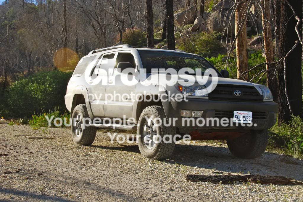

That's my setup. 5100s all around, front at 2.5 with FJ coils, superflex in the back (they're great). I also added LR UCAs to maintain factory alignment specs. I gained 3" up front and 2" in the back. Here's a few level ground pics...
BurbankLFlifted_zps193f07c1.jpg~original
DSC_0440_zpsedc98adc.jpg~original
And now some FLEX...
vlcsnap-2013-06-11-07h51m15s49_zps598601a6.png~original
vlcsnap-2013-06-11-07h49m27s67_zps99cb1c8c.png~original
Here's one that shows the ground clearance...
vlcsnap-2013-06-10-23h23m48s23_zps318cf541.png~original

Thanks! Mine is a V8. I got a little plasti-dip happy with the front grill. I agree with Casper, if you can afford the better coils up front do it. The ride is definitely stiff, but not harsh on the road. Very little flex off road tho. I was on a tight budget when I did my lift.
I put the UCAs on at the same time (got them used) so I can't speak to ride quality without them. Those were more for peace of mind. I'm not the only one who drives the runner, if ya know what I mean. The handling on the highway before the lift was crappy at best. Really 'floaty'. It's slightly better now.
Your 4runner looks amazing! Are there any problems that have come up because you set your 5100s at 2.5? Mine are at 1.75 and I'm considering to move them up a notch but I'm worrying about the negatives.
