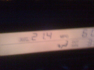

True record
62 mph
100 miles trip
Every single thread I have read about the on board mileage calculator says that it is at least 10% optimistic.
