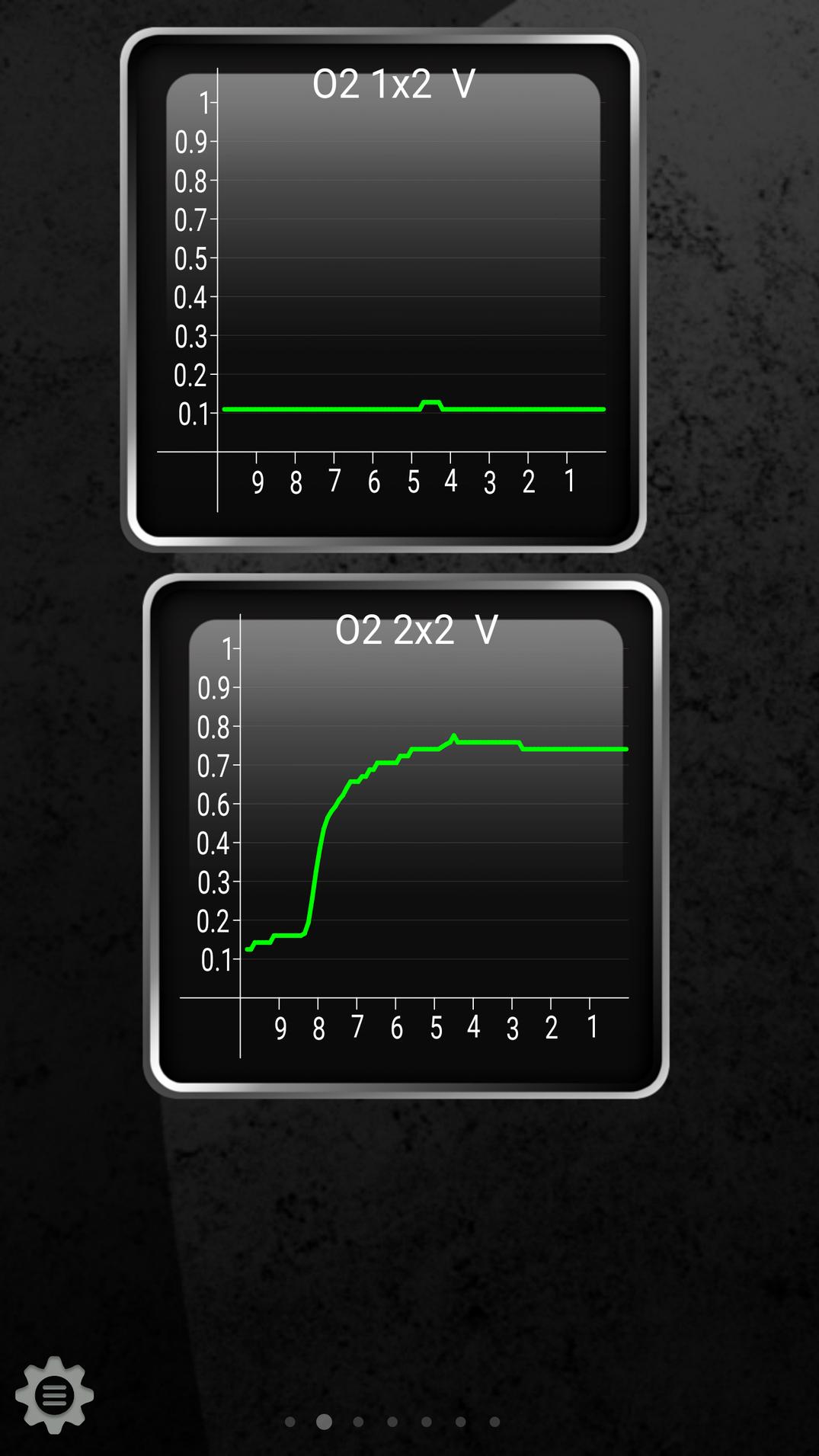

O2 P043 after Header install
I knew with the headers I would most likely need to do something with the O2 sensors. I'm not opposed to the simulators but I think I will try the spacers first since they are cheap and it sounds like most header guys have had this take care of their issues.
So what I am curious of is yesterday I drove about 30 miles with no CEL. This morning on my way to work on my first deceleration I got a CEL. Scanned it and came up with a P0430 (as I expected a 0420 or 0430). With the scanner plugged in I watched both #2 sensors and under acceleration and idle they run nearly identical patterns, however during deceleration I get this.
My question is this: Is my bank 2 sensor 2 not performing as it should or is there that much flow difference between the right and left DT header?
I realize they will act differently after headers and probably throw a code but my thoughts are that they would both change approx. the same.

I found torque lite outlet O2 sensor voltage data to be pretty unusable. While we're different in the fact that I got rid of my primary catalysts, I was able to get rid of P0420 and P0430 with 3 O2 sensor spacers (one drilled out, two left with the small holes) You could try it with less. There really is no need for the rear sensors but since you kept catalysts maybe you do want to know that they're working properly?
