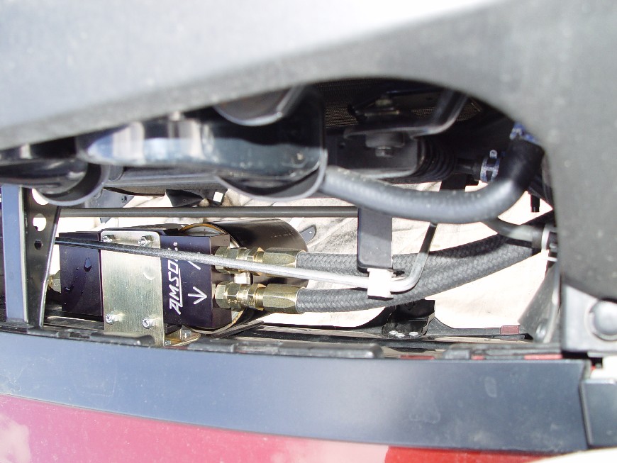

You could struggle and change the filter without removing the skid plate. I relocated mine so I could just reach behind the front bumper without even getting on the ground.

I sooooo want one of these, wish the price would come down a little.
I hate having to remove that skid plate each time. Adds another 15 minutes to the whole process of changing the oil.
There are several companies that make a remote single full flow system for less then $50 but I don't see any for the 4Runner 4.7 V8. Summit Racing carries them. It may be worth a phone call if someone is interested.
