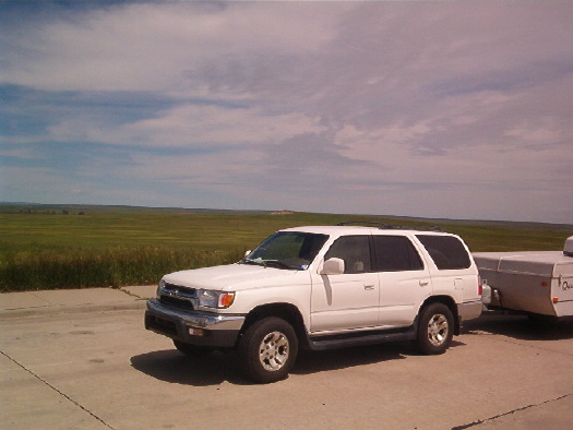

Yeah man, your old popup is great. It is a 2002, for me that is brand new. I was thinking of selling it after I went out west, but I have really been enjoying it. I have used it 3 times this year, the last time was Big South Fork in Tennessee. I got to visit Sgt. York's home, a WWI hero. We are going to North Carolina twice before the end of the year.
I am sorry to see you have sold your 4Runner, but I see you have a 1st gen 4Runner. I have been thinking of getting a new car. My Son, who you met in 05 is now driving and he really likes the 01 4Runner. I was thinking of getting a RAV4, but I am tempted to maybe get another 4Runner. See my thread here:
