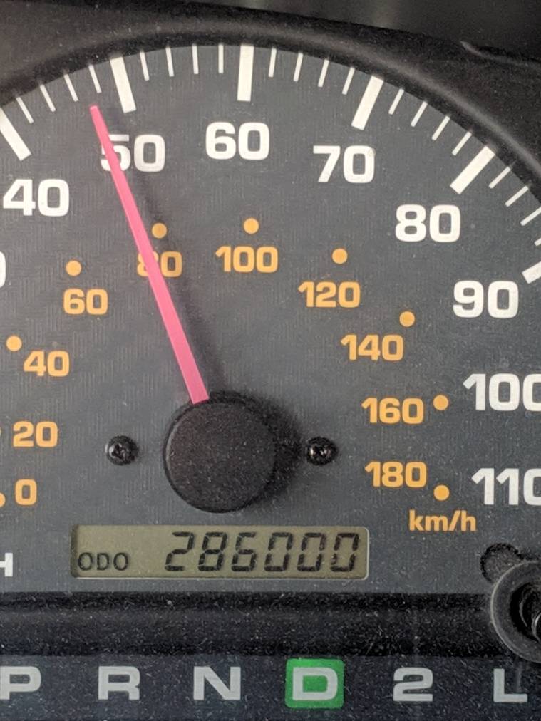

Bumping this thread from the dead because it's nowhere near freezing and my brake pedal has gone stiff on me 3-4 times in the last week. Nothing appears to be "off" in a visual inspection; vacuum hose is tight and intact and no vacuum leak observed (idle quality, etc).
I can do a DrCoffee and WD-40 the check valve, or I can replace the check valve and grommet but I fear the booster may be going south.
286K as of yesterday, and I'm sure the booster is factory original. Any thoughts?
It’s worth replacing it with that milage on it. I think they are around 40 from the dealer.
I got an OEM booster from DeathCougar 4 years ago or so. Way better than what the dealership or aftermarket wants for one. I seem to remember that it was around the same price as a replacement check valve, plus it came with a check valve, so that was a good option.
