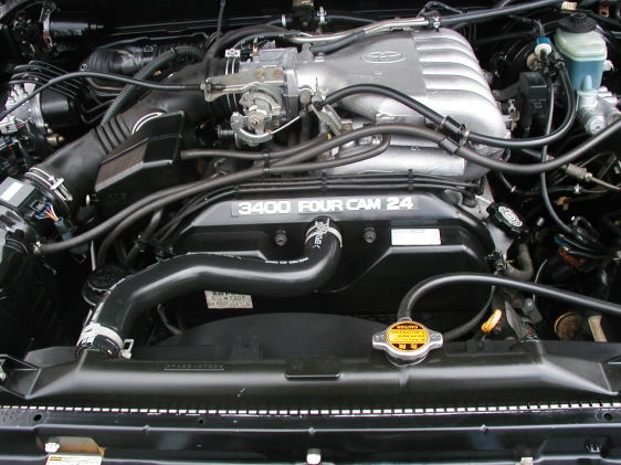

A picture of your engine bay would help.
On my 97 one goes to the charcoal canister. One goes to the metal line next to the manifold. Last one goes down to a silver breather on the power steering pump

Dang, pretty engine bay. What do you clean with?

Not mine. Stole that from the internet. However, if you want to clean it like that, get a couple detailing brushes, time, and APC and go to town. Wipe with 303 Aerospace and you're golden.

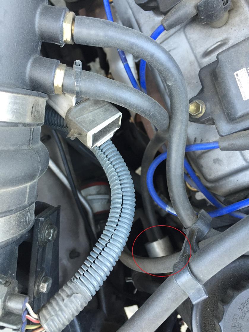

Look down past your power steering reservoir and see if you have the silver thing below. That's what mine connects to.

i don't think so. the only silver thing below my power steering pump is the fitting for the ac compressor.

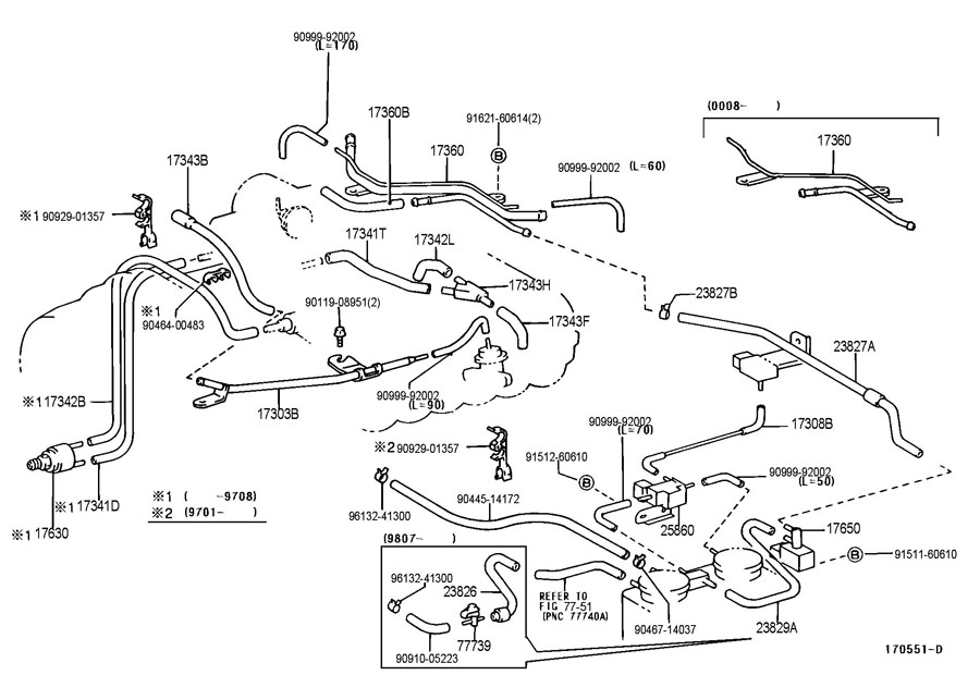

Dont know what to tell you then.Diagram for your car shows the same thing. Its actually a control valve for the AC.

i don't see anything like that on mine. does your aftermarket intake have something to do with that?
