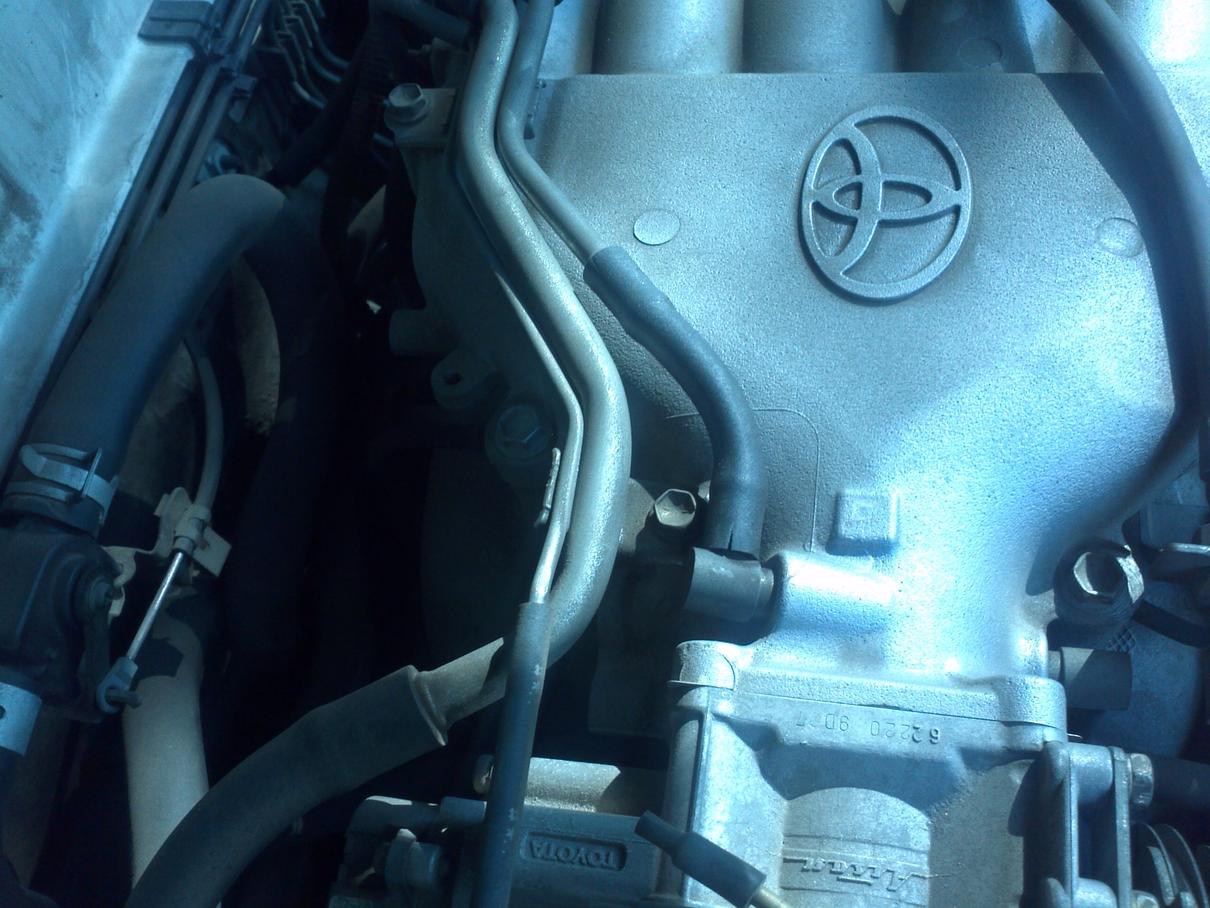

So here is the back story.
I work 5 miles from home, small town with light traffic and easy lights. I also travel seldom and it's typically on light traffic occasions.
Then I went to a lagre city for work; and may commute there daily, soon. So while waiting for the light over two light cycles my truck began to iddle rough. Turning off the air conditioning helped for about 45 seconds but then it just died. It started right back up and there is no cel. during the rest of the drive, I turned off the air as i coasted towards each light and during the next long light, as it began to idle rough again I just put it in park and kept the idle up. Got home with no further issues.
This rough idle has been for a while and I've turned off the air before; just never had it stall in city traffic before. I'm sure that you can see this becoming a HUGE problem if I begin to commute.

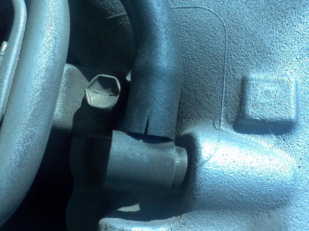

All of my experience points to a vacuum leak?? am I right? i opened the hood looking for the vacuum lines and found this coming right off of the top of the intake manifold. Thoughts and suggestions would be greatly appreciated. Am I looking in the right direction?
Thanks for your input.

Yeah, it's part of the EVAP system. Mine was cracked a lot more than that for a while and I had no problems. I eventually replaced it, but not because it was causing problems. That's my experience. Good luck.
From what you're describing, sounds like a vacuum leak to me too. But look around, that little crack in that hose doesn't look bad enough for it to be stalling IMO. There are a few lines running under the intake and on the underside of the throttle body.
I have to go through my truck and replace some as well. Just haven't had the time. I think I'm just going to buy a few rolls of various sized vacuum hose and just start replacing them all, cutting to length as I need it.
Thanks all for your input...
