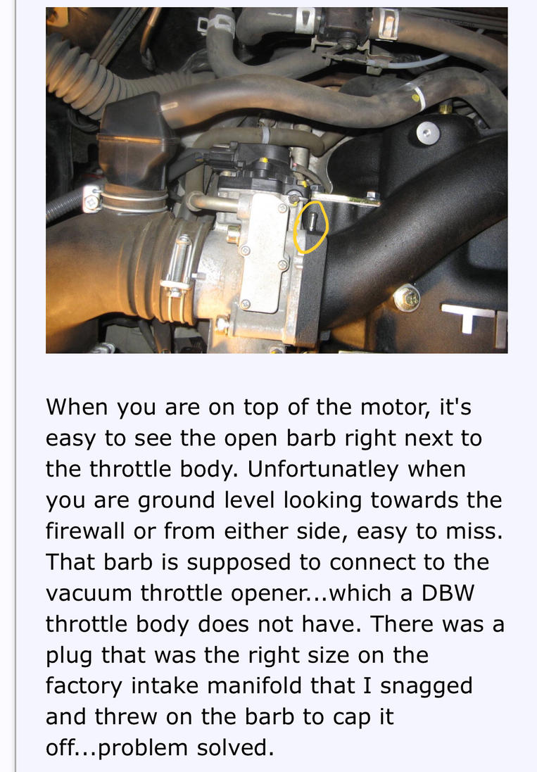

Well... leave it to these wonderful communities to help fellow Toyota owners out: this post on Tacoma World depicts my exact problem / source of the vacuum leak. Plugged that and it idles warm right around 14.8 AFR. A step in the right direction and I now have a truck ready for tuning :cool:
Thanks again guys!
