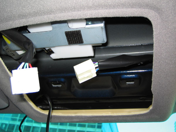

First, I popped out the overhead map light assembly although I didn't really need to do this. I thought about fishing the power cord through it to get to the V1. You'll see that I changed my mind later on and pulled it out from the headliner.

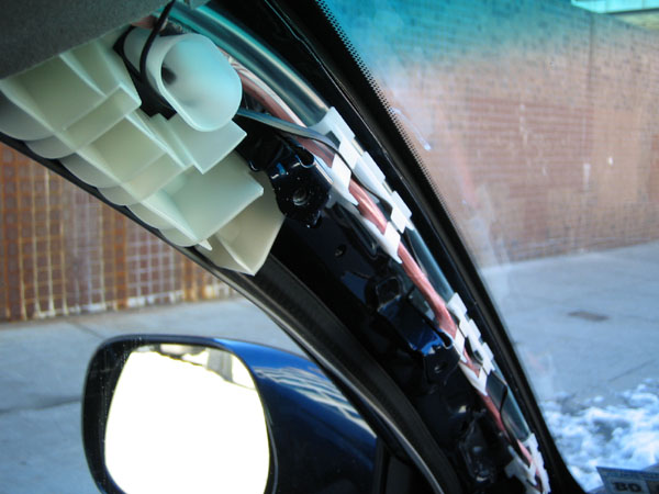

You can string along the power cord to the driver's side a-pillar. To take it off, you have to pop the 2 covers off the handle (the "oh sh!t grip") that hide the screws. You can use a philips (#3) or a 10mm socket. After you get the handle off, grab the top of the a-pillar cover and pull gently. It should pop off. Run the wire down the a-pillar and secure with zip ties and/or on the plastic wire guides down to the dash. Fish the wire down underneath. You'll have to take the bottom cover off. There's 2 10mm screws on the lower corners and it will work itself out. Careful, there's a plastic ring around the ignition that will pop off when you pull the cover.

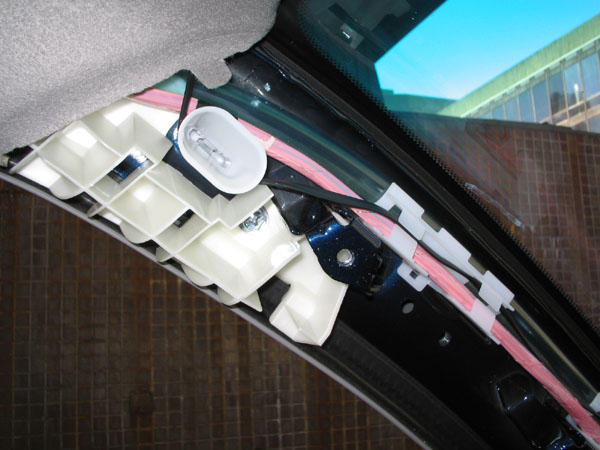

This pic is when I took the wire out of the overhead console and just had it come out of the headliner.

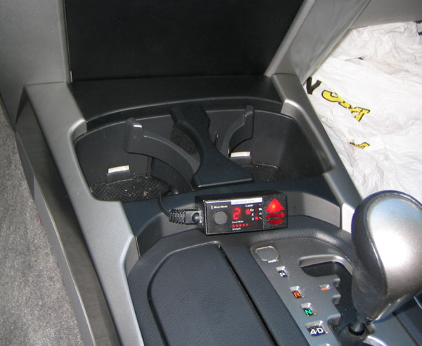

I ended up putting the remote display here.
There's a great site that shows how to take the whole center console out and I used it to install the Scion HU so I was familiar with it.

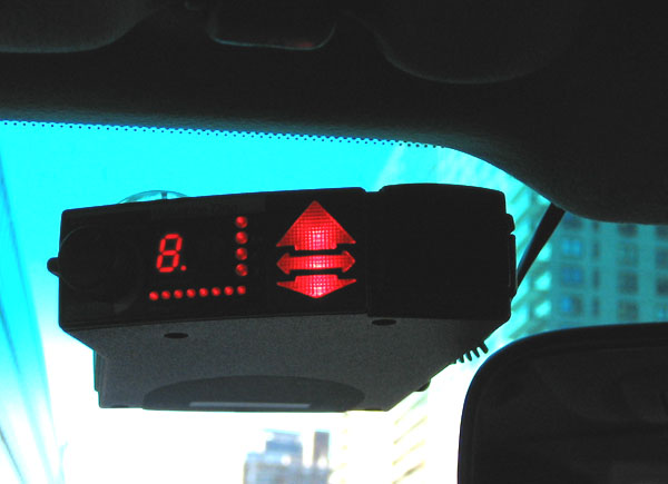

V1 mounted above the rear-view mirror:
I like this mounted here because you can barely see it. I was pulled over for speeding, and didn't have time to take it down. The CHP officer never even saw it up there. Also, other drivers can't see it either, especially since the lights never turn on (because of the remote display)
