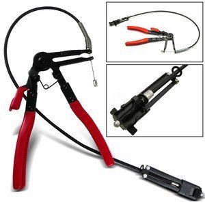

Also buy some wire harness flex covering 1.5-2 in diameter, rated at 500+ to replace the factory harness that will undoubtly fall apart on the drivers side when removing the valve cover-its super brittle. I tried to alumi-tape it but it just crumbled under the tape. Buy the (I think you bought) hose clamp tool I sent you part #-which is fast becoming my favorite tool. 10mm, 14mm, 12mm flex sockets help too.

What was the hose clamp tool you recommended? We all want to know :yield::sadwave:
ABN Flexible Hose Clamp Pliers For Fuel, Oil, and Water
