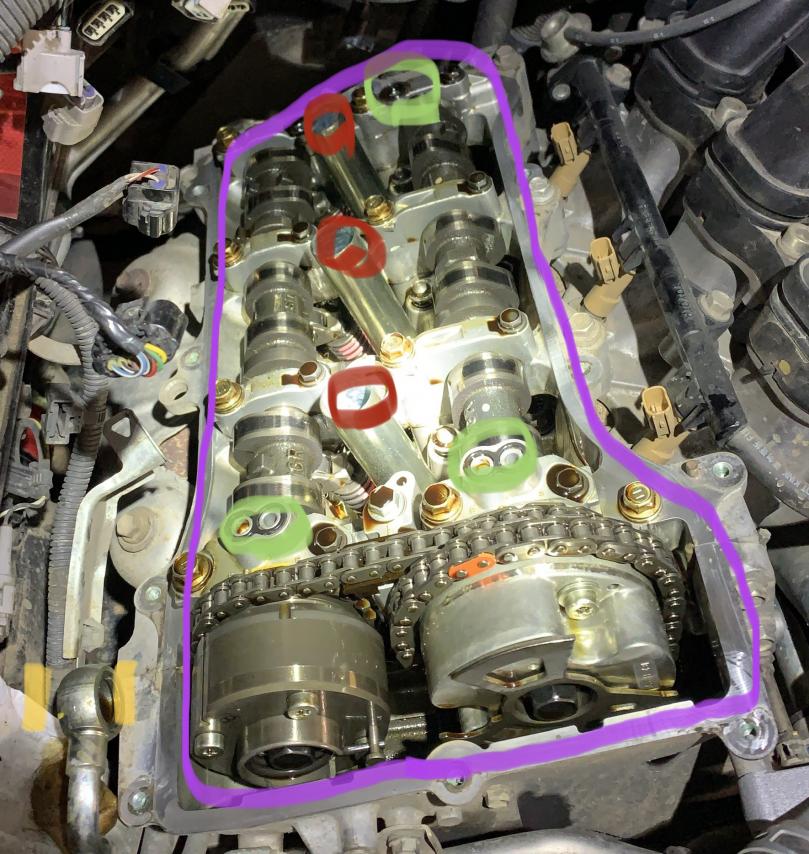

the first 3 part numbers are what were used to replace mine and spark plug o ring seals. I did not require the intake manifold gasket to be replaced so I don't have that part for reference
In addition, 18 sealing washers were used 90210-06013 and I did the camshaft gasket at the same time
camshaft: 11159-0P010 x 4 and 90430-10024 x 2. I had this done at the dealer
Here’s what you need to replace
thanks, do you remember if any sealant was used on the valve cover gaskets?
