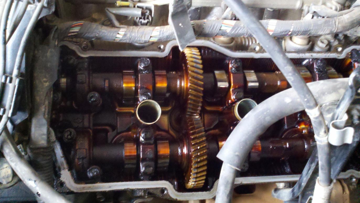

Be careful not to let that plastic fall down into the cam when you have the valve cover off...with mine I didn't even have to remove the bolts holding it down cause it all just crumbled away. Even with it there though, I don't think you'd need to unbolt it. There's enough room to work. Lets see some pics of those valves when you have the covers off! Here's one of mine...after all the plastic had come off the wiring...
