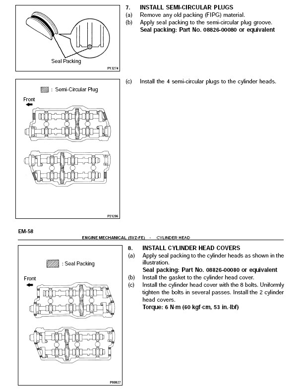

I've been getting everything ready for my upcoming valve cover gasket replacement job and I wanted to go ahead and print out the pages from the factory service manual so that way I had all the torque specs and everything.
well I spent a lot of time looking around, a lot of time searching, and a lot of time looking on the web and I can't for the life of me figure out which section has the information on the valve covers. The only thing I know is that people on the valve covers themselves is extremely low and specific, just this is so critical I definitely want to make sure I've got the right information.
Does anyone know where in the FSM it details the valve covers?
It's listed with cylinder head R&R.

It's not all listed in one neat little area in the FSM. You have to search through the EM (Engine Mechanical) pages to find all the related pages or you could just use our video as a tutorial because we list all the torque specs you'll need for the job.
Well damn I would have never looked in the cylinder head area... Haha.
