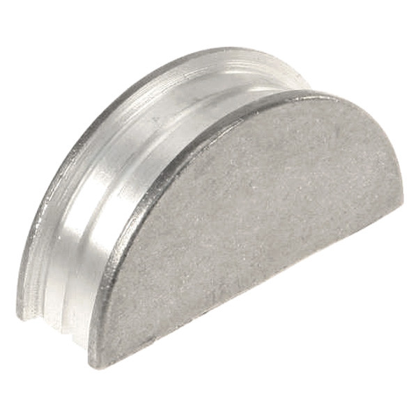

Cam plugs are circular rubberized plugs that kinda look like freeze plugs, which are on the back of each head. Half moons are the half circle aluminum pieces that recess into the front and back of each head and are sealed with FIPG or similar sealant.
Cam housing plug:
Half moons (also called semi-circular plug):

Wtf are the point of these? Cam plugs somewhat make sense from an engineering standpoint... But the half moons? Seems like a designed hole in the damn head. Why?
Sent from my LGMS428 using Tapatalk
I think it's from the machining process.
