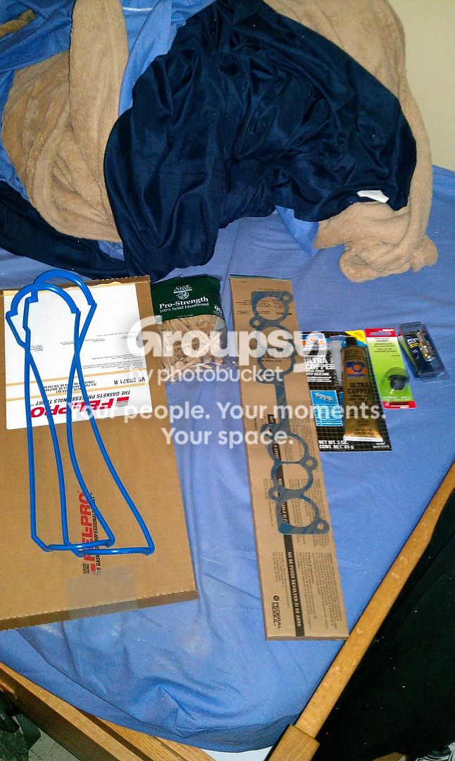

Everything you need todo a valve cover reaplacement, everything was from autozone and costed 40.23 and the Gold Tees costed 3.00 bux at Wal-Mart.
1. Intake Plenum Gasket
2. Valve cover Gaskets
3.Pcv Valve
5. Pcv valve grommet
6. Hi temp. Gasket sealer
(the golf tees were optional i just bought them to plug the lines so antifreeze wont leak everywhere)

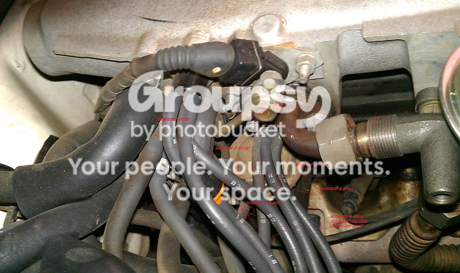

I ordered 2 foot of Pcv hose so hopefully I can get around it. But I'm waiting on the engine to cool down. Also when I give it gas it kinda.skips and.sputters. Damn vaccuum lines I musta hooked them up wrong :/ anyone have pics or a diagram
everything you need to know about hoooking the hoses back up, i noticed they were numbered and i hooked them all back up correctly now the truck runs good!!
