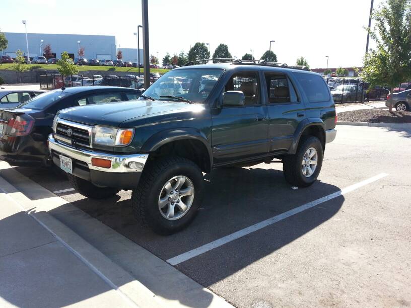

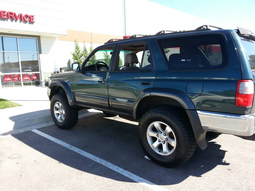

What sizes tires do you have? That front end looks a little jacked. Also, 'looks" like some positive camber up front. What are your hub to fender measurements. Take a picture of your CV joints.
I'll be switching wheels and checking ujoints today or tomorrow and I'll have to let you know how it goes. And sorry the pics are pre- alignment. It had a lot of camber, caster, and toe issues. It's much better now. Tires are 285/70r17.
