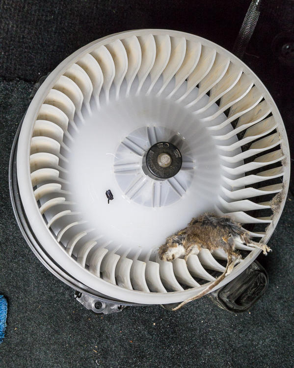

I posted this already a while ago but maybe it's worth posting again.
This is what I found when I pulled my rattling/vibrating blower motor:
I've actually seen pictures of a mouse on more than one occasion while searching how to remove the blower motor!
unfortunately photbucket has made older forum posts completely useless. I can't seem to find any good photos of the removal
Is it just 3 screws and remove the power connector?
The air inlet is open to the cowl & this is why you get mice & leaves in the vehicle.
When in recirculate mode, the door is closed. (You can see the nest.)
When you select something other than recirculate, the door opens and there is direct access to the duct work. I've had mice build a nest on top of the filter as well as chew thru it and this is how you get mice in the vehicle. Not only that, when you or a dealer checks the cabin filter, and leaves or debris on top of it will fall into the fan. It only takes one leaf to create a racket.
I fashioned a quick & dirty hardware cloth screen for the interim to keep trash & critters out. Toyota should have done something like this to begin with. I plan to fab something a little nicer since i have to mod the new 4R as well.

Same with me after almost a year, couldn’t take it any more. Tire out the old blower n installed a new aftermarket.
Nice and quiet again. Very simple procedure.
