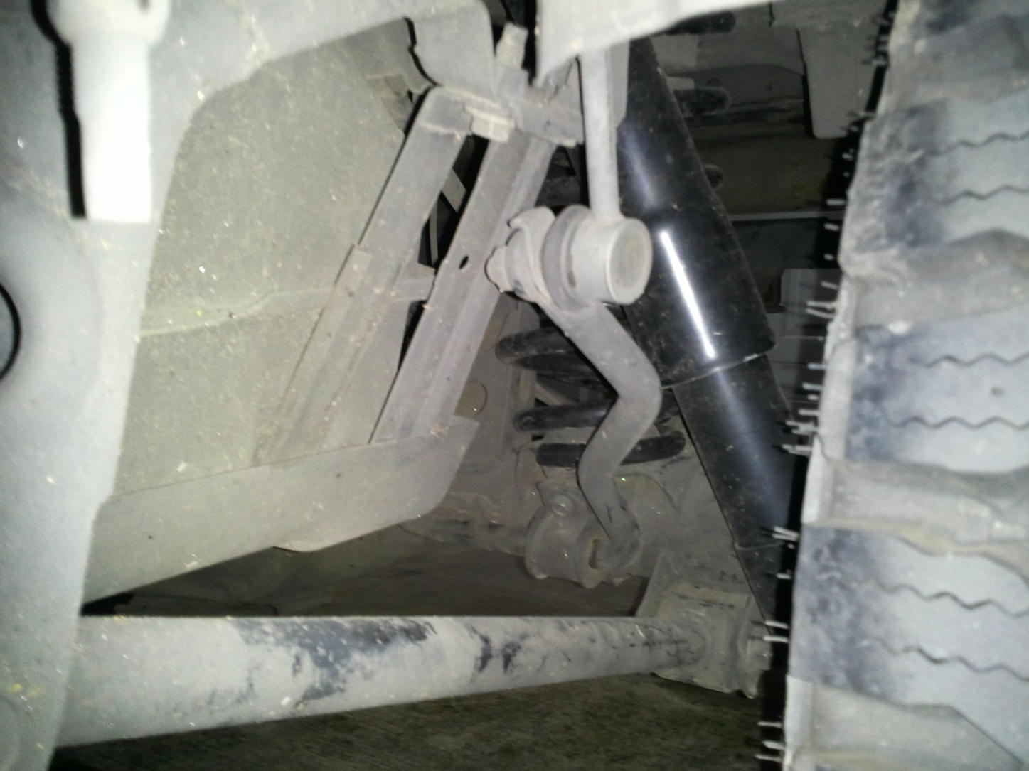

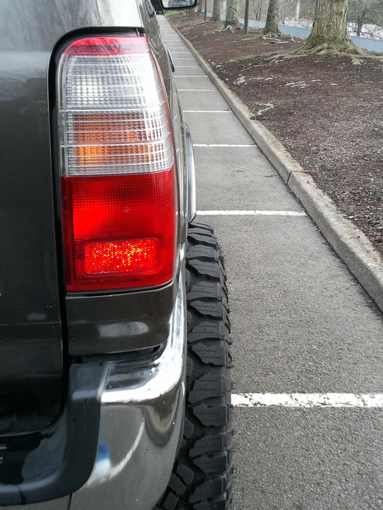

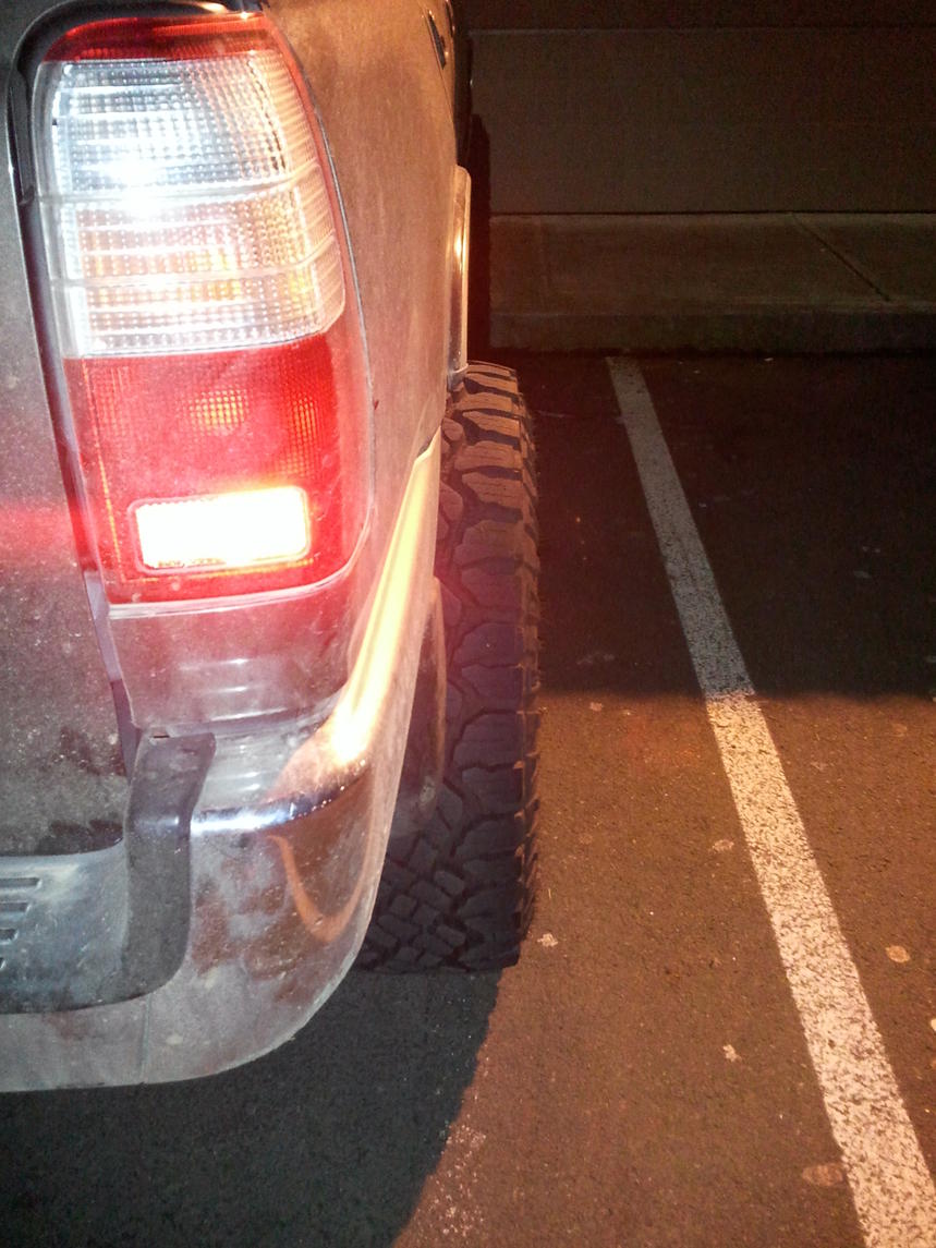

Well the tires still clear the UCA so i don't think thats it. I will check the ball joint in the morning though. I took some pics so here they are. also included the sway bar angle, could that have anything to do with it?
Also......would the diff drop have any effects like this?

You put 315/75-16 tires on your truck? Is there any rubbing anywhere?

Yeah, don't get worried until after your alignment. That's a huge change to the suspension and it needs to be adjusted to it. Your rear axle doesn't look that bad to me in the pics. One pic is a lot closer than the other so it's hard to tell for sure, but measure it, it looks like it's only ~.5" off to me.

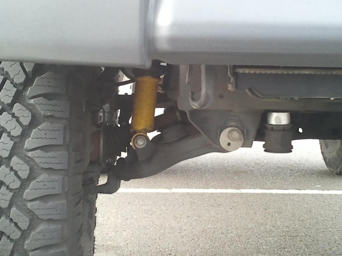

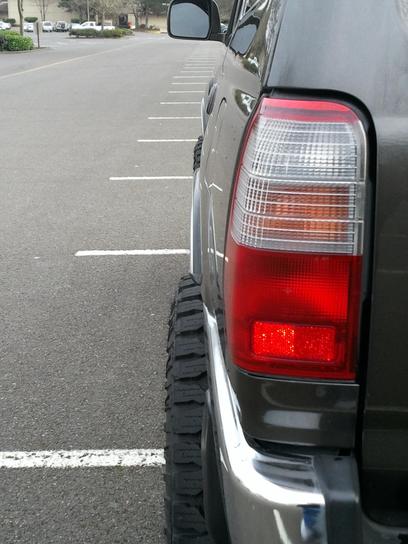

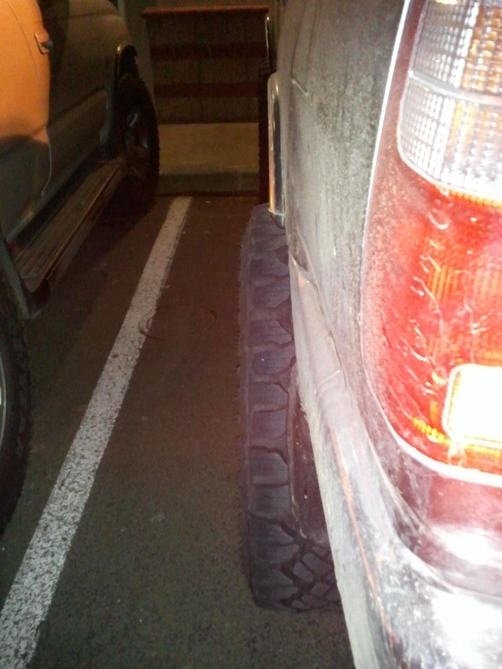

Here is a better shot of how far the tires stick out plus a shot of the cv angles
